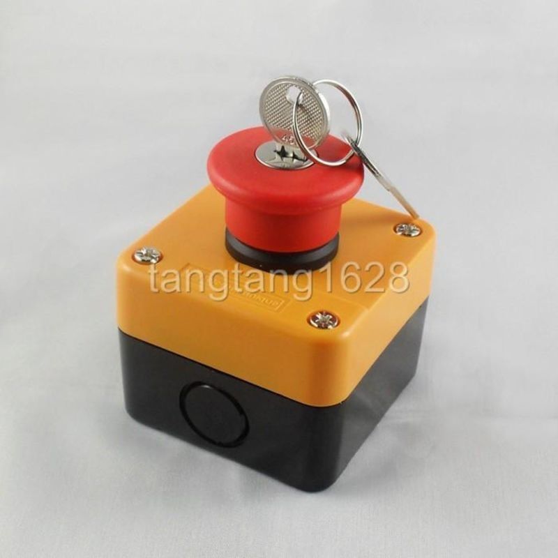

38 Special uses a normal toggle that trips a large continuous run solenoid on the firewall. But, it is not obvious to someone reaching in the buggy to assist like the one I use in Solo Buggy.
You could go with something like this:
http://m.ebay.com/itm/221120873442
Wire your ign & fuel pump relay triggers through it.

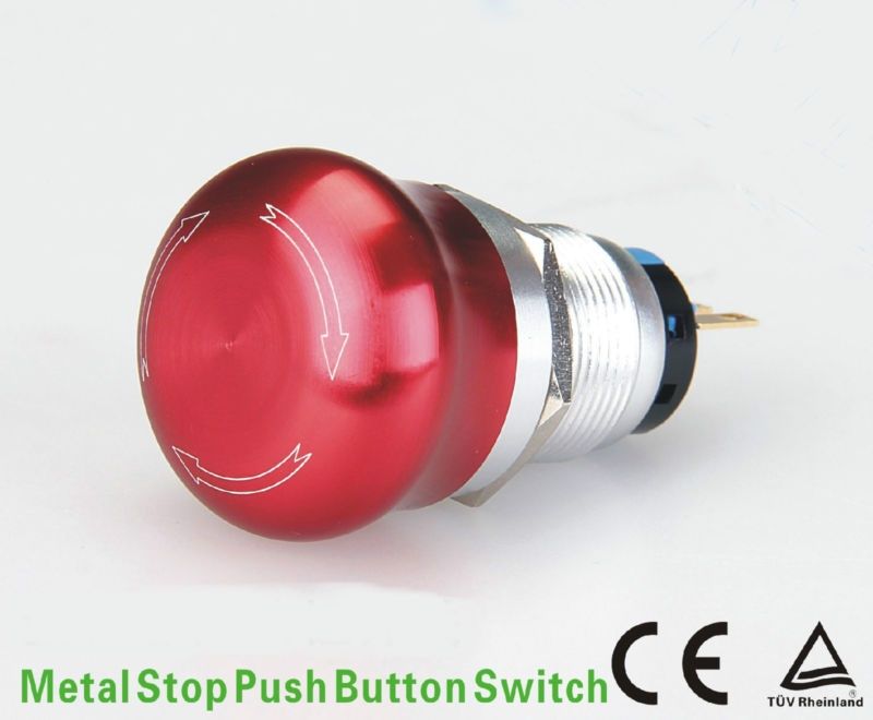

Sent from my SM-N920V using Tapatalk
I just bit the bullet on a couple of those switches to see what works best. I figure at that price I'd get em and see how they work out and if not I'm out a whole $10 for 2 switches.

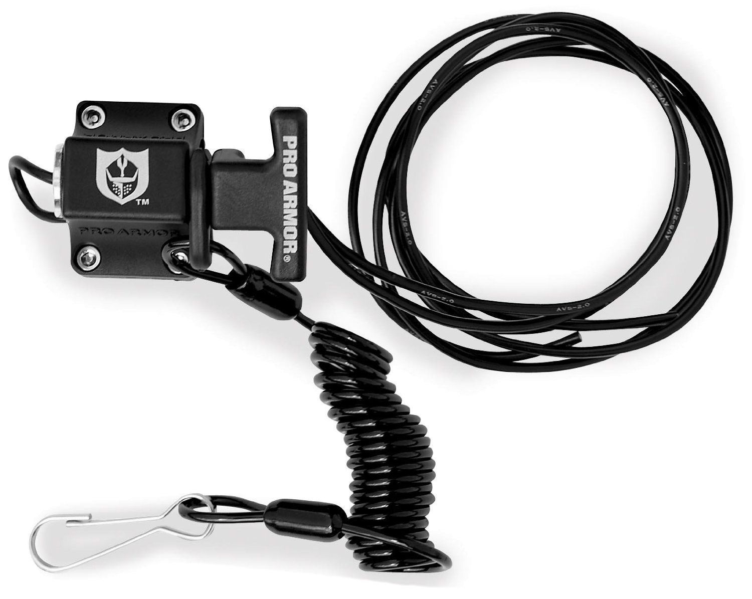

I wired in a driver tether from a boat to kill the motor and fuel pump, pretty simple setup that seems to be what you are after. I found the ignition wire and fuel pump wire and spliced the switch into them. Once pulled it kills the motor and fuel but still allows the winch to work for self recovery if needed
