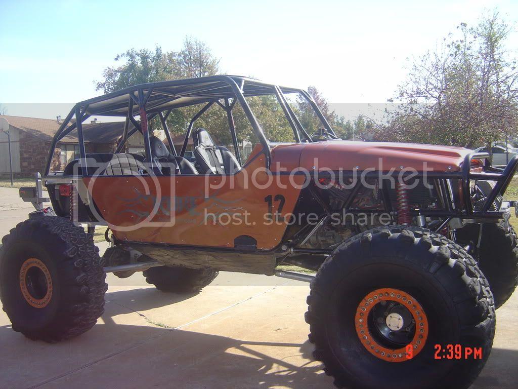

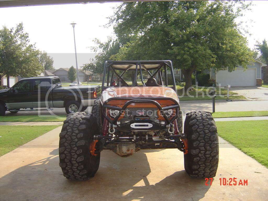

Beyer......that buggy in your avatar looks pretty bad ass. Pics / specs?
1TONTJ said:
Yeah, that's probably what I'll do.........or hell.........I might buy enough to build a complete buggy and say the hell with my full body Jeep. loller.gif
The chassis is For sale. :popcorn:
It is a KORE 4-seater.
115" wb
1-tons
44" TSL's
Vortec 350, TH40, Stak 3-speed
