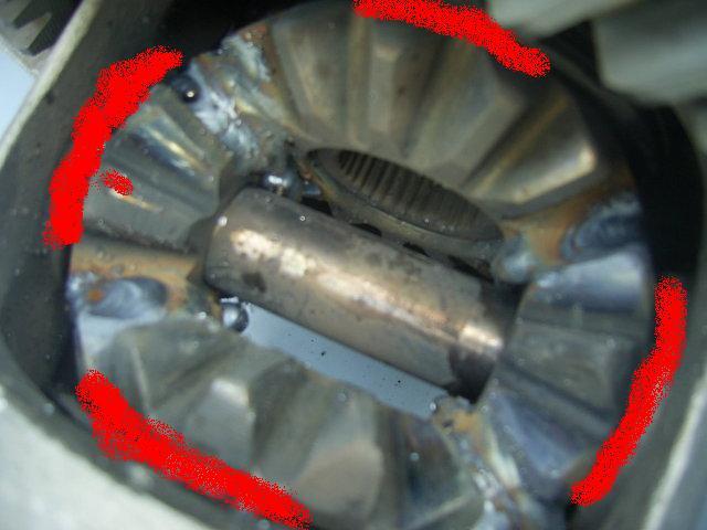

Shortly after putting the 60 in, PUO form AWOR came over to my house, help me pull the rear diff carrier out of the Sterling 10.5 and weld up the spider gears for me. PUO you rock :awesomework:

that welded rear isn't going to hold, good lookin truck none the less! through some plate between those spider/center gears
You need to add welds here on both side of the carrier. That set up you have is not going to last.
Thanks for the heads up on that. Hopefully it will last long enouph to get some money put together so I can change the gear in my axles and upgrade to some better lockers. I'm still new to this so the more info the better.

Lay some weld where Brian indicated or you will lose R&P when them welds break....And they will break been down that road. Still a nice rig on the cheap tho....:awesomework:
Let me know if your interested but i am more the willing to throw an extra couple welds onto that carrier:awesomework: I dont know where u are located but I live in Burien and Duvall, So I can pretty much meet ya anywhere or I could bring my mobile setup and do it for ya whereever even in a parking lot if you want:cool:

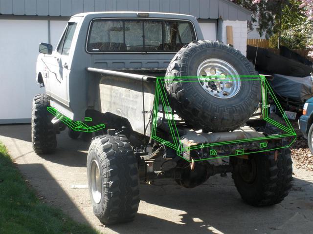

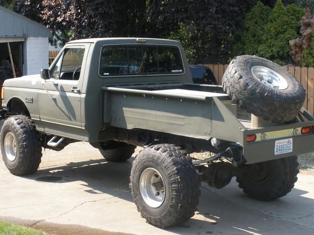

So I decided to get rid of the flat bed and put a Chevy box on the back of my Ford. Thought I wouls share a few pics of my build.
1st. Pic was me brain storming what the truck would look like.

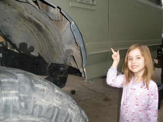

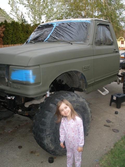

Pics 2 and 3 are of my little helper (Abigail) who helped me take out the body lift and put some paint on the truck. She was having a blast as you can see.

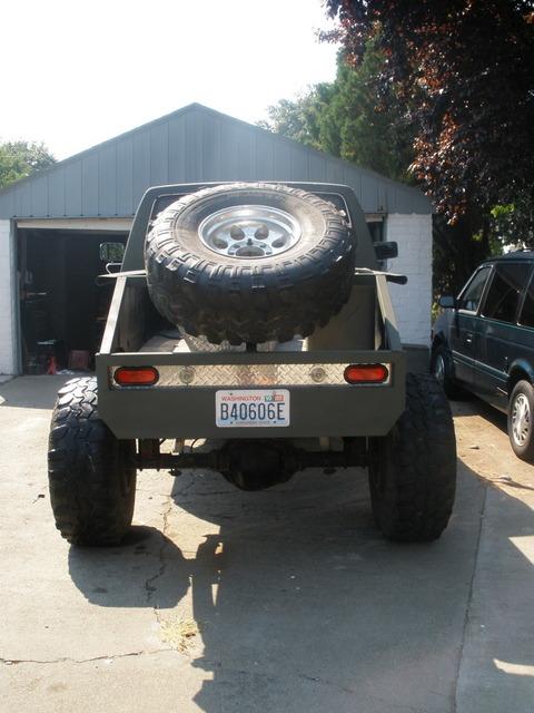

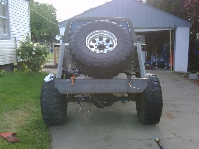

Pics 4 and 5 are of the bed mocked up and some steel layed in place to give me an idea of what is was going to look like. It actually took a lot long putting the rear tub together so that is would fit on a Ford frame. But was worth it in the long run.

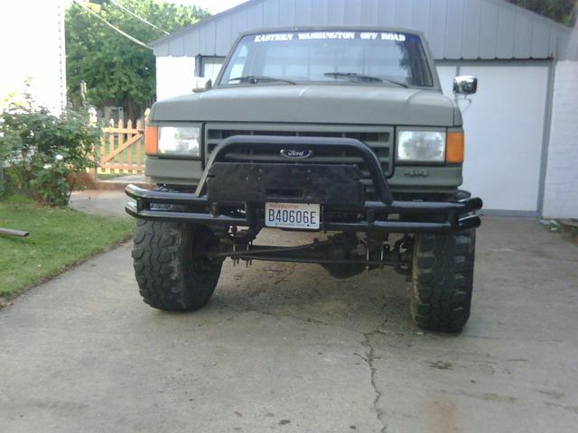

I picked up a bumper real cheap and spent a few day cleaning it up and a couple more putting it on my truck. Not the meanest bumper but it will hold a winch.

Here are some pics of the bumper put together and tire mount finished. Almost finishes at this point.

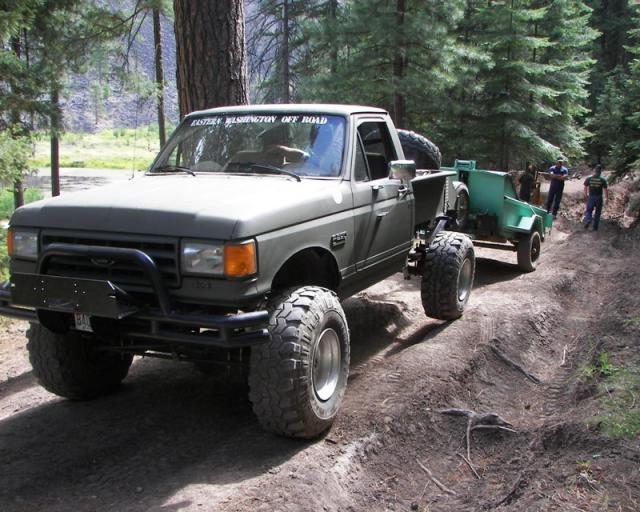

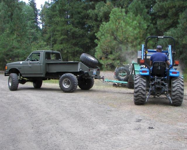

Here she is back on the trails again. The pics are from a trail repair on 4W608
