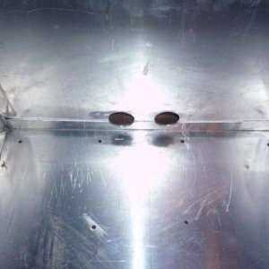

My floors and panels are .090 aluminum.
I used trick tabs with captive nuts and these from McMaster Carr to bolt it all together.
