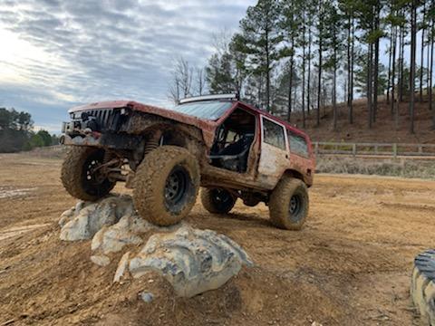

I need advise to install a fuel cell in my 96 xj.
