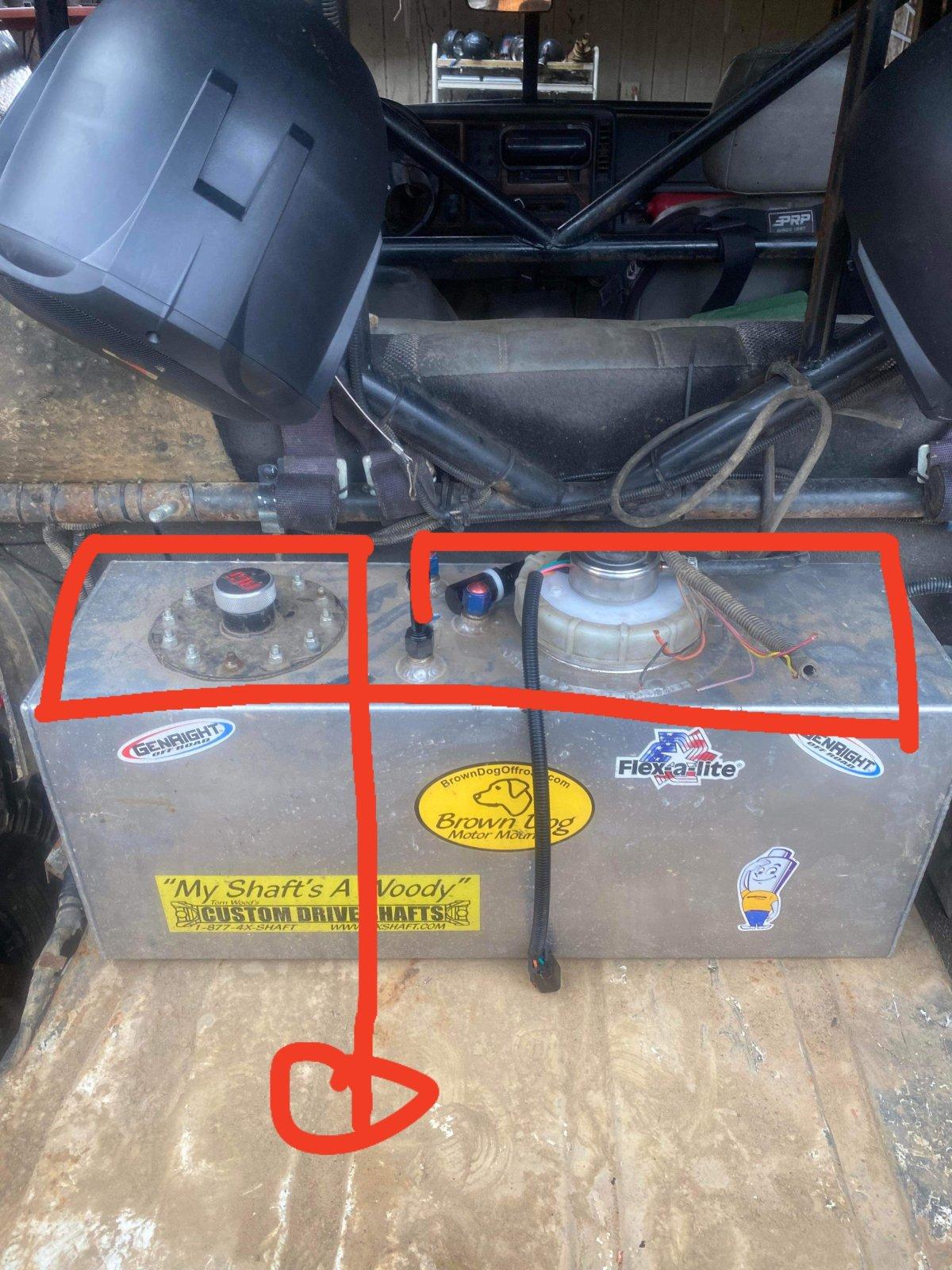

Will this be adequate to vent the tank and not leak gas? Comes out of tank, down pass side, across bottom, up driver side, across top then back down pass side?
Only needs to come up to that driver rear corner...the rest is overkill. Just imagine turning the vehicle every direction...if theres always a section of line above the outlet at the cell you're good to go.
Well part of the thought of across and down again was that if it was going to leak it would be going away possible back seat passangers instead of pouring on them. Technically it should go forward then, if it got stood up on its back then it would pour out.

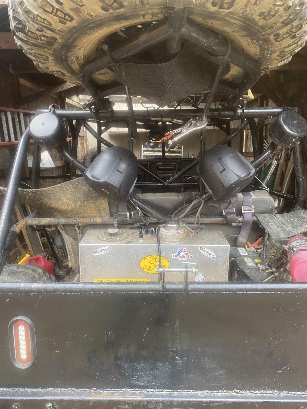

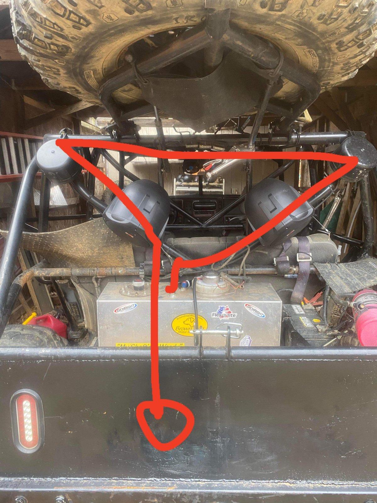

If it were mine I would route like this.
From the tank to the passenger c pillar/ belt line node (near the clamp) then forward up the belt line tube to the harness bar, then turn to the drivers side to the drivers belt line tube, then back to the driver c pillar node then turn down and go a few inches below the floor in the corner by the ratchet. The hose would be clamped, tied whatever on the inside of the belt line and would not get hit by rocks and look clean
Long story short around the tank up high down through the floor.

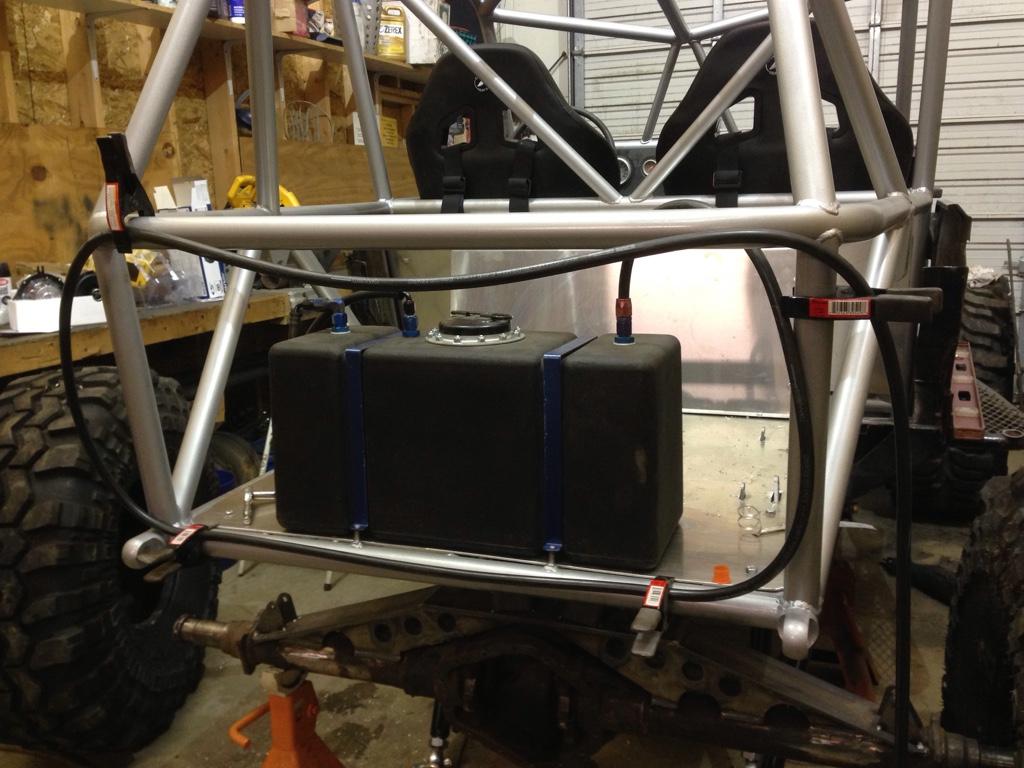

Not really...the way sleepsontoilet did his is about as clean as you can get and be effective. You have to have air between the end of the hose and the tank...or it will leak. The way those rollover valves work is the ball bearing has to be completely seated in order to block the fuel. So like they said you'd have to be on your roof and the valve would have be perfectly straight up and down in order for it to seal.
Ending up doing this, around the top then down and out the pass side on the other side of the ammo can
