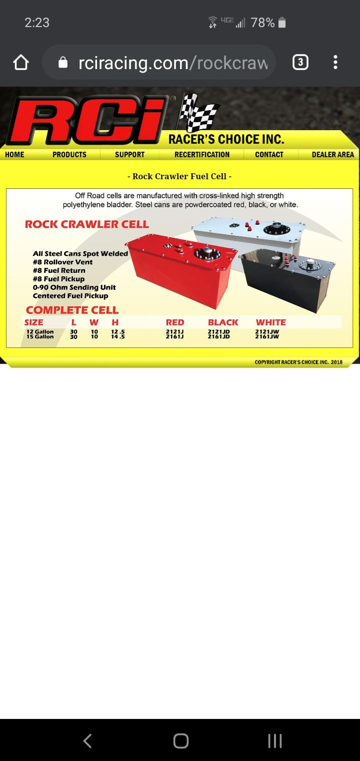

RCI sells a tank with a plastic liner specifically for off road. My aluminum one cracked a couple yrs ago like most everyone else's does. When I called for warranty I upgraded to their new one. Same size as the 2161.

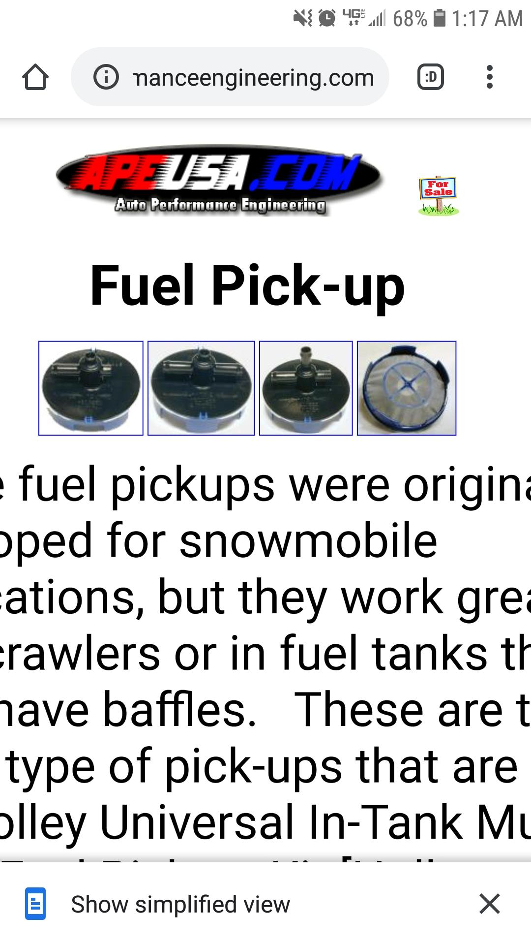

What can you do to fix the fuel splashing away from the fuel pickup other than keeping it completely full all the time?????
you can use baffles in the tank to mostly do that
they come in lots of options... foam, plastic, aluminum
foam - only use high quality stuff. NOT the stuff from summit. it will break down super quickly and clog up everything. even the best foam will still break down over time.
plastic - there are companies that make fuel baffles out of a specific kind of plastic that doesnt break down. youll fill the tank up with these (people used to use wiffle balls, but they will break down over time too unless made out of that very specific plastic) and it will stop the fuel slosh
aluminum - have some baffling and trap doors welded into your fuel cell
there is also the option of using something like holley hydramat, or even normal fuel pickups inside the tank as a fuel pickup
