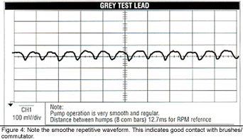

if you look at the pump on a waveform pattern you will see (most times) a bad pattern when the pump gets warm. The armature wires start shorting when the heat causes the wires to expand. This increases the amperage and causes contact failures.
You can predict most pump failures by pulling the pump fuse and putting a lab scope in its place and watching the pattern when warm.

Current draw may be viewed using the fuel pump test connector hooked with a jumper to battery positive and measured either using a multimeter or a current probe. We prefer to use the low current probe and view not only actual current draw but view pump waveform to confirm pump condition as well (see Figure 4).

4. Fuel Pump Current Waveform
Figure 4 shows a very good pump with a very smooth repetitive brush contact with motor commutator. Experience is required for this type of testing, but again, knowing what to look for is the key as well as viewing many pumps in your day-to-day service of vehicles.
Our experience has shown that this is the most correct method of analyzing the overall pump condition and determining, beyond a shadow of doubt, that the pump module does in fact have a problem and require replacement.
