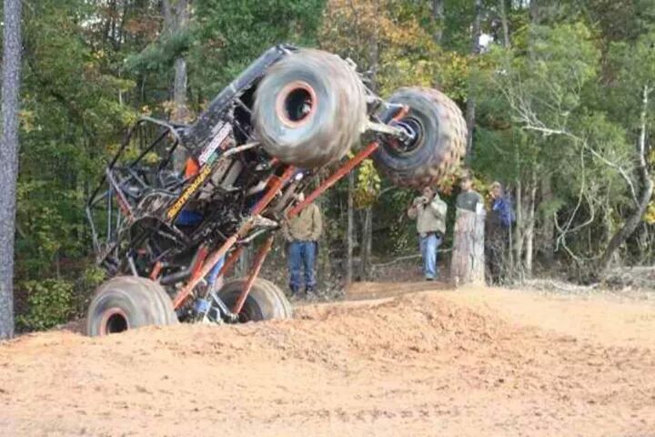

o I'm killing 205s too forgot to say I'm 650+hp
