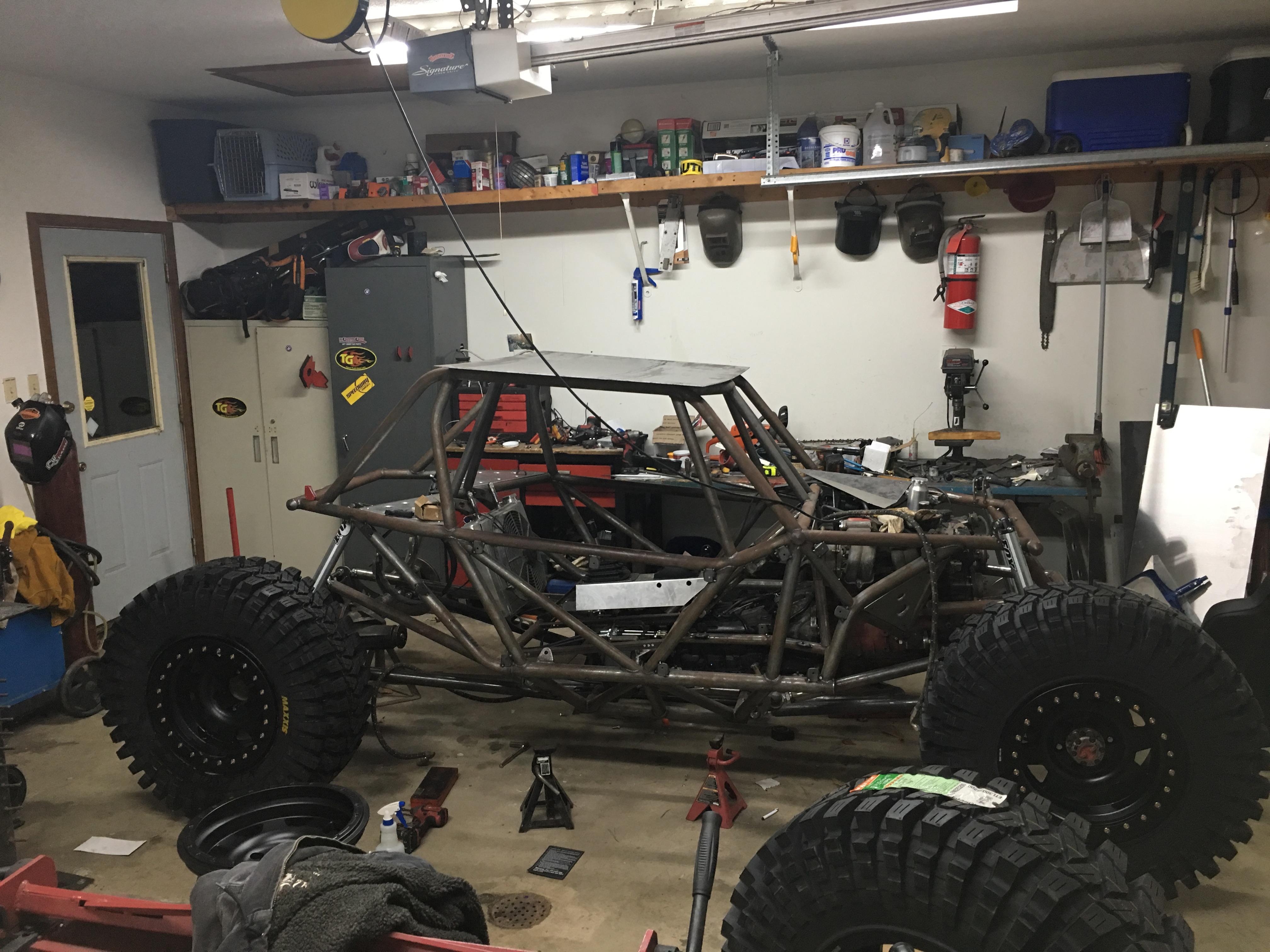

Throwing around the idea of installing a hand break on my buggy so I can do some front digs . Buggy is still in the building process so now would be the time to do it . I'm running a 22r on propane with Aw4/dana300 never ran auto or a Dana 300 so this set up is new to me. I've been reading up on some but would like some input from some one who's done it and what set up did u use. All the diagrams I've found on the pass through says to install it inline with your brake line with no line locks straight from the master cylinder on the vehicle does this work well ? I've also contemplated just having the hand brake operating the rear brakes with no assist from the foot pedal . But I'd like some feed back before I do anything , I've added a pic of my build just so you can see what I'm putting it on .. any input would be much appreciated

I had one on my jeep (aw4 and dana 300) installed in-line on rear brake line only. When pulled by hand, no pedal input required. Not saying this is the correct set up, but it worked. That said, I very rarely used it so I removed it.

Ya if I don't end up useing it I guess I could always take it out . Never had the opportunity to do front dig before so thought I'd give it try and pipe it inline thanks for your input
