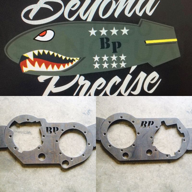

I make these rear np205 crossmember supports
