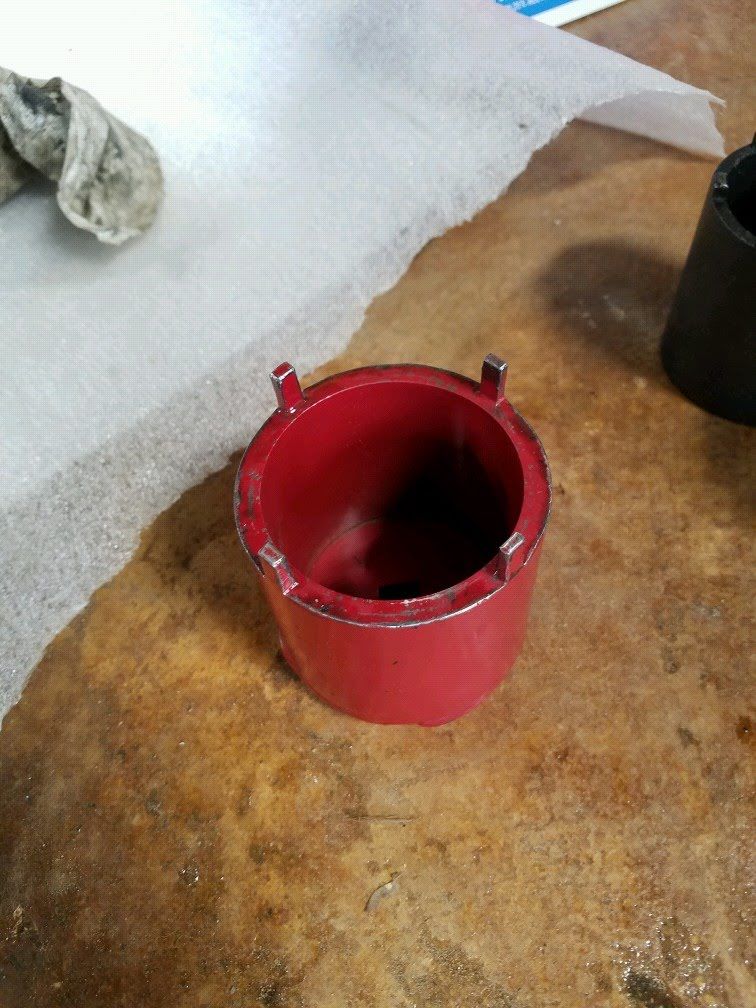

If that doesn't work I have another I will sell you. I don't need it anymore.
Thanks! My initial thought is no the 2 5/8 is definitely too small. However it looks like the one you have might have been modified by taking material off the inside of the teeth. Let me check and I will shoot you a PM about buying yours.
The W83010 fits my rear 40 spline nuts but they may not be N11. I'm going on memory here and it has been awhile but I'm pretty sure the red one was custom built for the N11 nut and I ordered it from one of the now broken links off that P4x4 thread. The problem I had with it was it is too thick to fit inside a 14 bolt hub. But it should fit inside a front hub.
