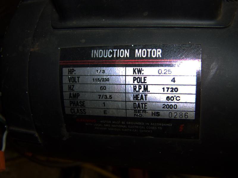

So my motor on my horizontal band saw quite literally went up in flames. It was quite old but prior to the motor it worked perfect..
I got it from tool town and was made by "foremost machinery" but it seems they are no longer in biz. The saw looks identical to the one harbor has thats made by "central machinery" but I can't find any separate listing for a motor for there unit.
My saw number is "MAMB 128"
Any help finding a replacement would be great.
You should be able to get a motor from Grainger. I am assuming that it is a belt driven saw. If so, then the dimensions of the motor (so it lines up properly) and the output are all you really need. Grainger can be a pain for an individual to deal with, but I would be really surprised if your shop doesn't have an account. If not, I am sure that there is someone on here with an account.

found the replacement motor for a "grizzly" band saw which is very similar to a harbor freight one..
here is the link for their replacement motor... and it is like $105
linky
if the rest of the specs and mounting will match your, it is reasonably priced
There is nothing on the outer part of the motor that says anything about the manufacture of the motor. I suppose I could pull it open to see if there is anything in there.
But thanks for the links I will look them over and see if I can find something and I will compare that one that grizzly has..

This looks like the motor. The only thing I don't get is it shows 2 different motors in the picture :eeek:
yeah.. looking further into their site, they just have two of the styles in the same pic (stock photos of both chassis styles)...
but from what I researched, that part number has been used to replace the motors on many tools, such as the band saws..
and the price is really reasonable...

So I finally got a chance to pull up the spec sheet on that motor and its 100% identical :awesomework:
Going to order one up tonight...
