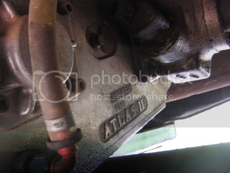

I was about to drop coin on a lomax in the next month.5. I really want an atlas 3.8. I need one for my new rig so I can use the gears I have and not go to 4.88 with a 3.0 case.
if its 4.3, heath needs it in a bad way.

here's a pic of the atlas
