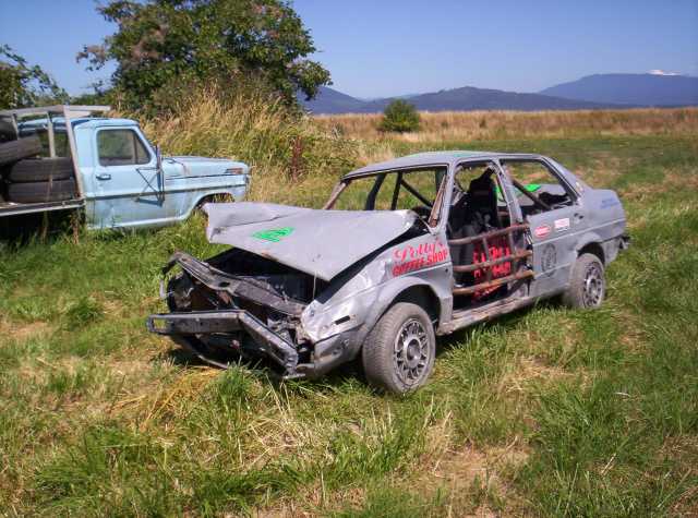

I built 5 cages for racecars using 2 holesaws from home depot i beleive they sell lenox brand. BTW the cages were made from 1 1/4" secdule 40 pipe as it is allowed for our class ande is alot cheaper than tube here is mine after a 7 time roll over at about 65 mph
