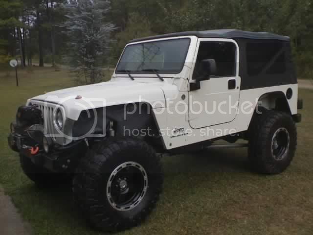

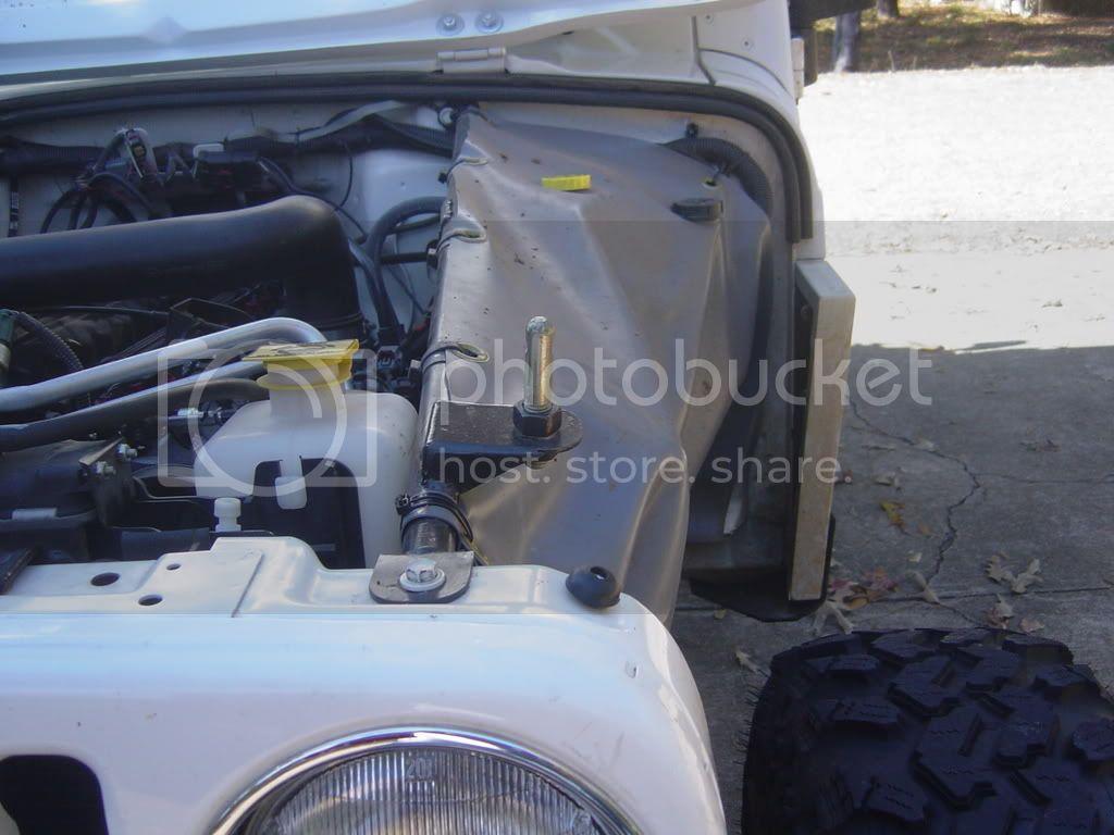

Pics of Penn's TJ with pins installed.

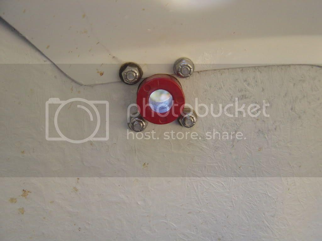

This shows the inside on the fiberglass. The small washers are going to be changed out for a rubber-backed 16 ga. laser cut plate with the hole pattern to help distribute the load.

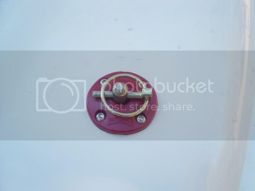

top side
Nice pics, I was just about to ask! Did you have to do anything to suppor the back edge of the hood (where it meets the fender triangle)? I don't have an inner fender so it flops a lot at that location. We were thinking about just using the stock TJ hood latch do secure each side to the fender triangle.
At the time of installation, it did not flop at all. It was a pretty thick hood and supported itself well. I will have to ask Penn if he has noticed any flopping since he has driven it at interstate speeds and wheeled it now.
