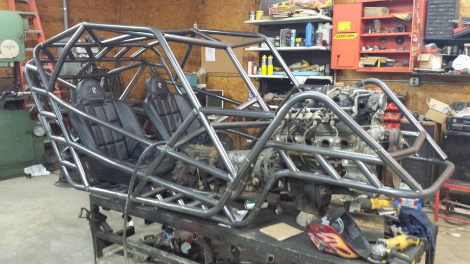

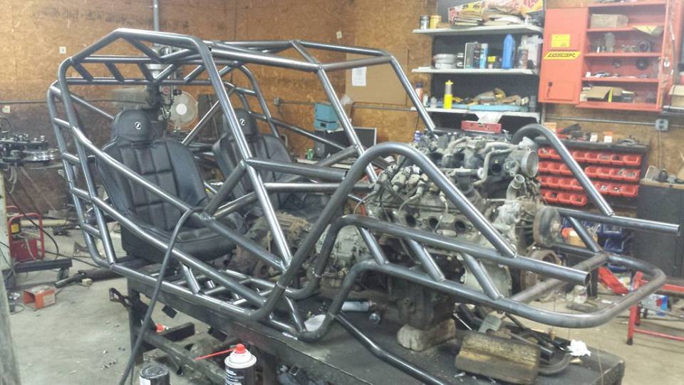

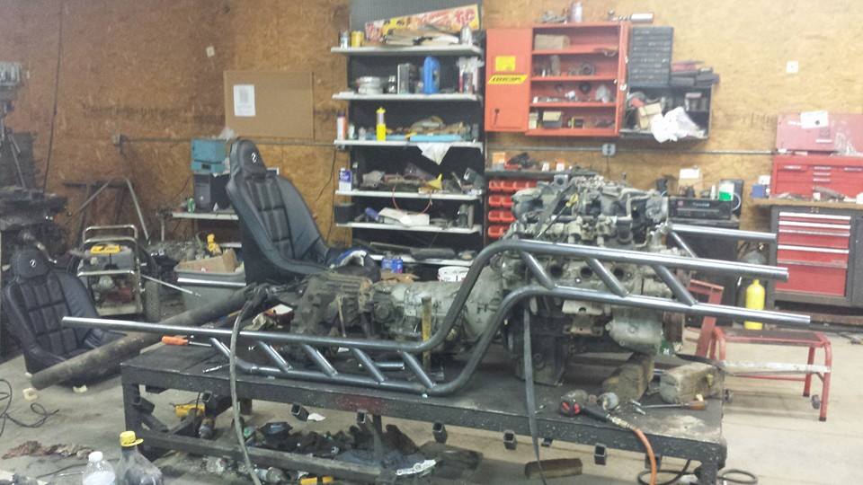

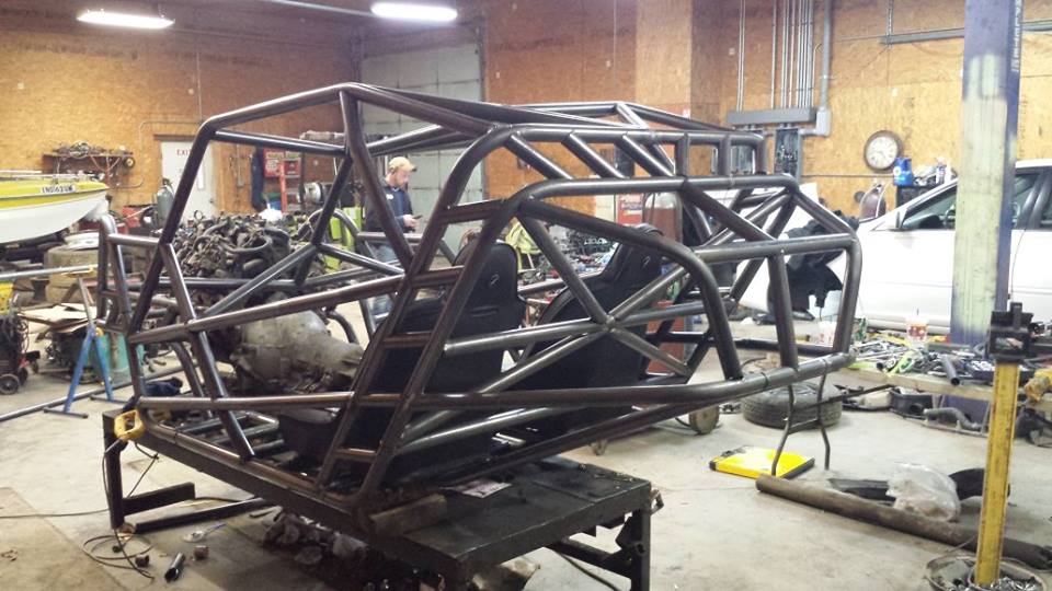

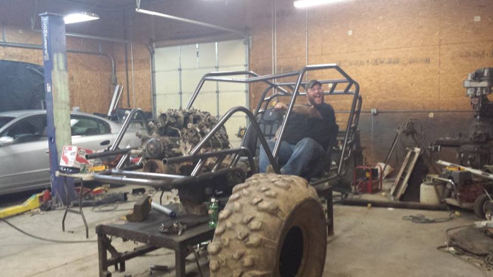

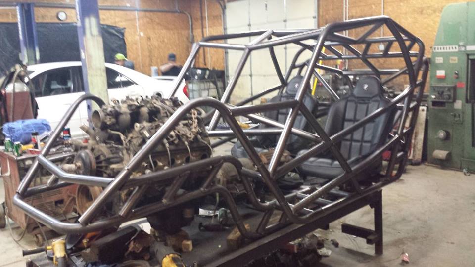

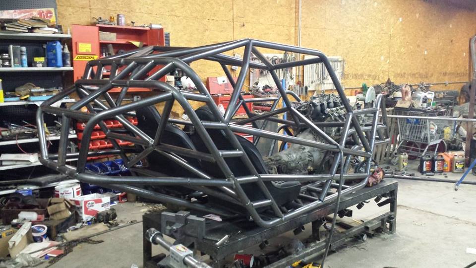

My buddy Dean and I started a buggy about 2 months ago. I wanted to build something that I could really be proud of and represented myself. Ive never been in the military but a lot of my friends are and I have the up most respect for our servicemen so I wanted to build something that was inspired by them. Hence calling it the " Hoorah Buggy". Cant wait to get this build done and get it out in the woods. Going to powder coat it desert tan with the shocks, floor pan, fire wall, fuel cell, seats and bead locks black. The body panels in going to hydro dip in digital desert camo with the dash in American flag hydro dip. Ill post pics as I can and get up the specs as soon as I can. Hope you all enjoy!

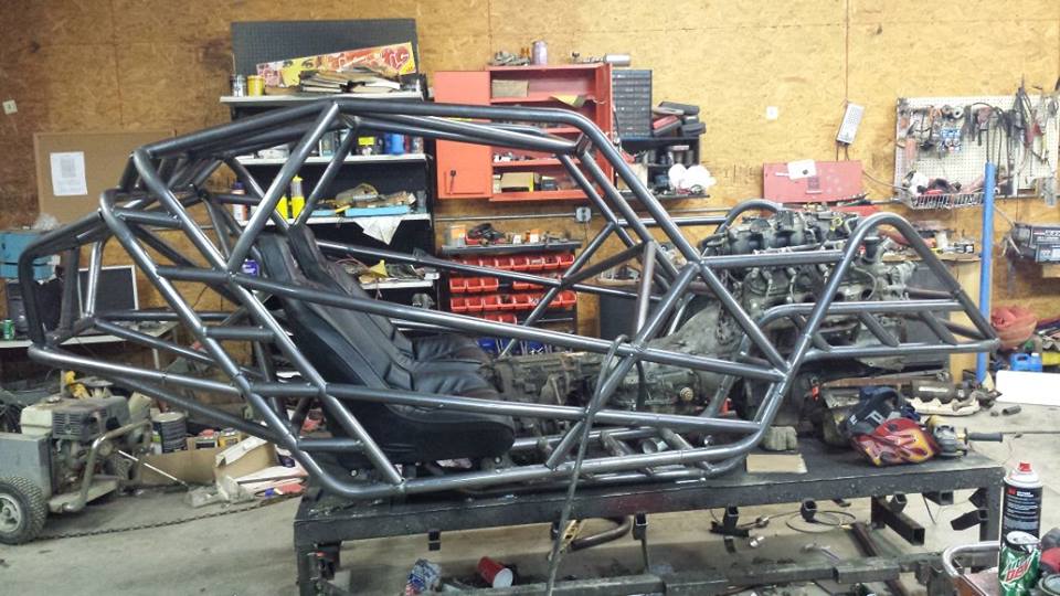

Few more......

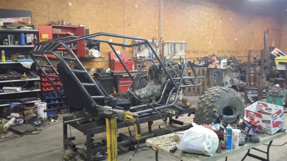

Coming a long.....

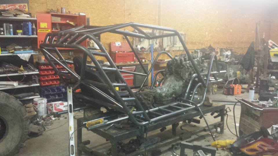

Starting to really take shape.

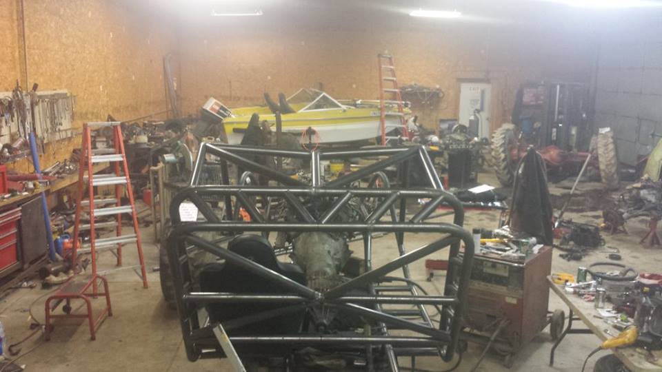

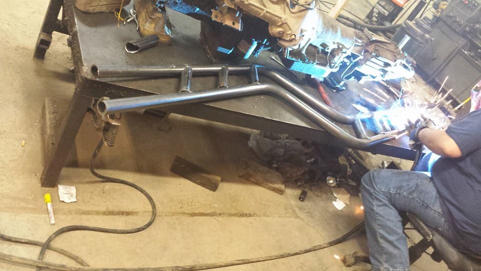

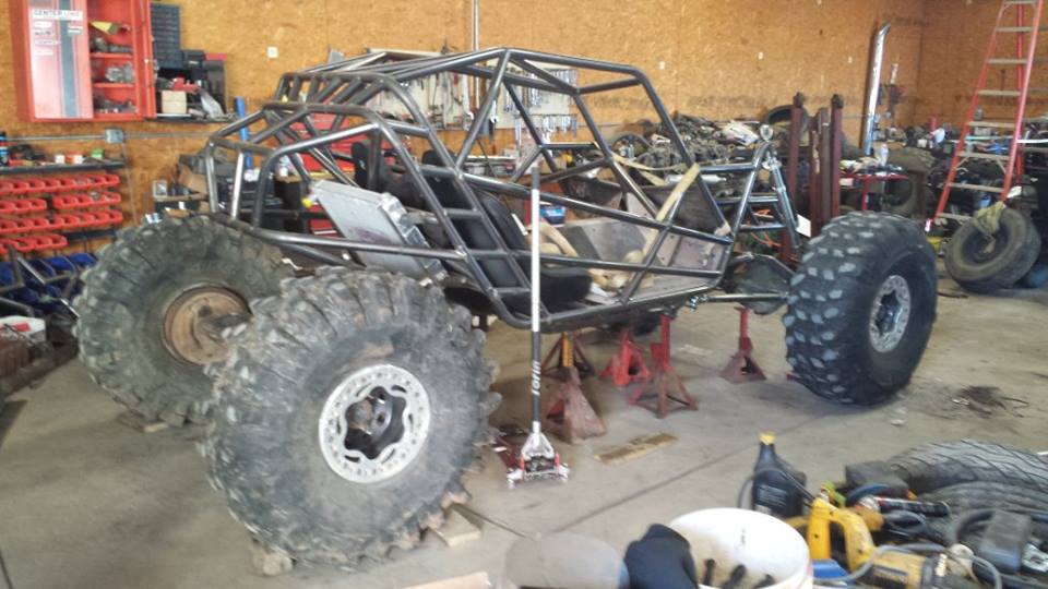

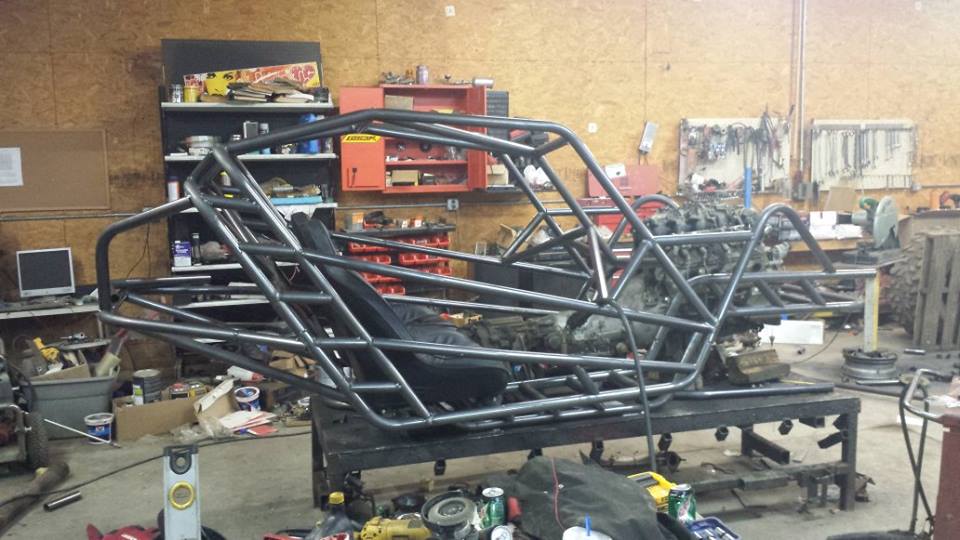

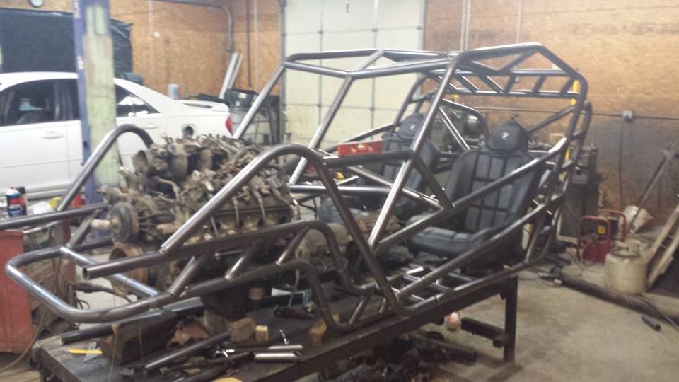

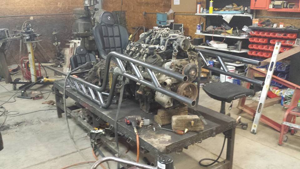

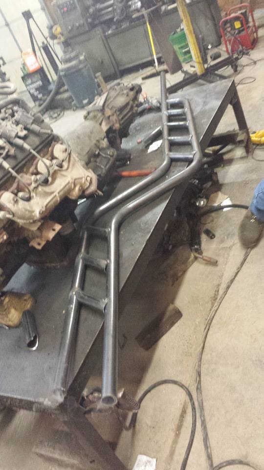

Chassis pretty much done and starting on the floor pans and fire wall on Saturday. We only get to work on it on Tuesday night, Thursday night and most of Saturday.

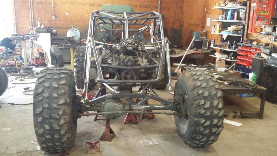

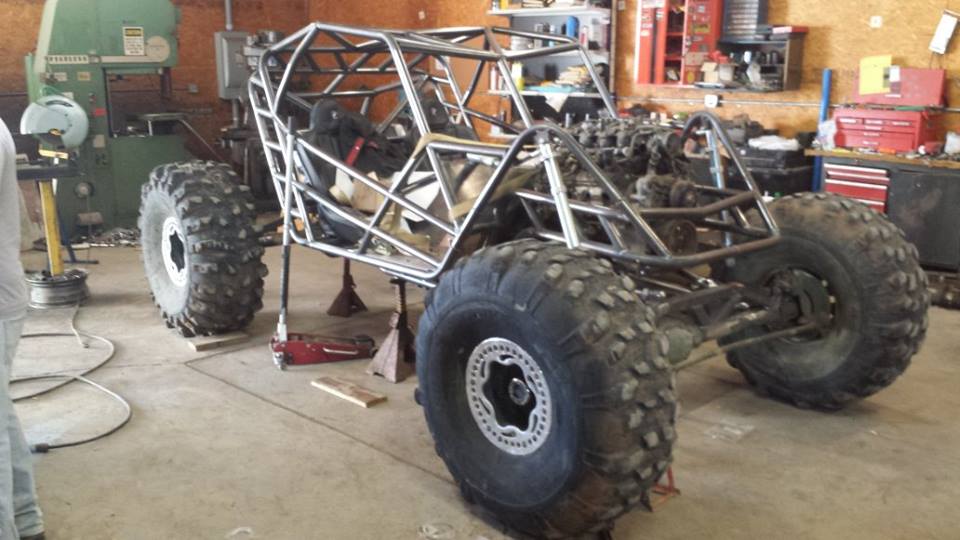

-60 Front
-14 bolt rear
-Chevy 6.0L
-TH400 with a 208 transfer
-Hoping to run 180 degree headers
-18" FOA shocks and looking at running 5.13 or 5.38 gears. Not sure on the axles just yet. Got a set of cut 44s on double beed locks. I need to take some more pics and post them. We got the floor pans and fire wall done Saturday the battery box mounted. Man o Man this build has been a blast. Ever better Im getting to build this with a good buddy.
Hoorah!

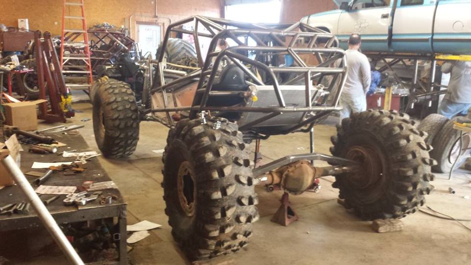

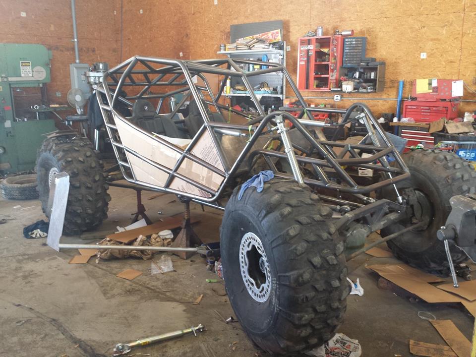

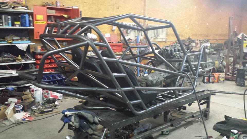

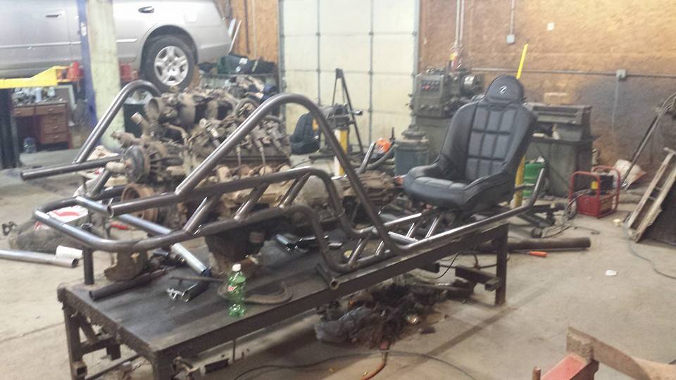

A few more pics of the build. SLowly buy surely this beauty is taking shape!!!

johneddie said:
Lookin' good man! :dblthumb: Think your color scheme/graphics will be the flashemifyougotem!
X2 on your color scheme/graphics!! Buggy looks great!! Nice looking boat in the background looks almost like one my grandpa had when I was growing up.
Yeah I really hope the paint scheme and powder works. I see it in my head but hope it looks good on the surface. Bush Hog pretty sure those tires are your old ones LOL Dean said he got them from you. Love hand me downs on a project like this.

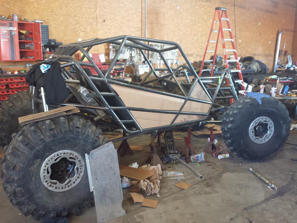

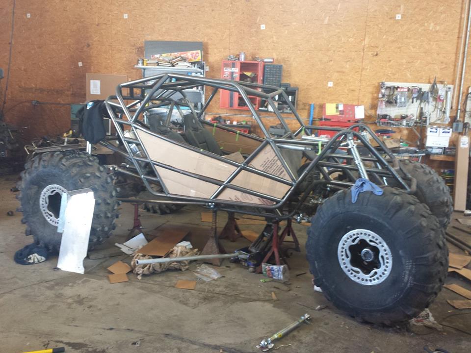

Messing with the panels today......cardboard cutouts are great. Dont want a ton of panels but I think this might be just enough. Coming together slowly but surely.
