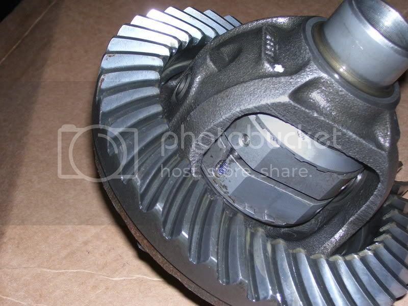

Pulled the carrier outa teh Taco and found that not only the springs had took a crap in the lockrite, but one of the inner plates had broke as well allowing alot of slack in the assembly..
So here's the Paul Wall method of Permanent repair to a junkrite.
1.. Find broken area

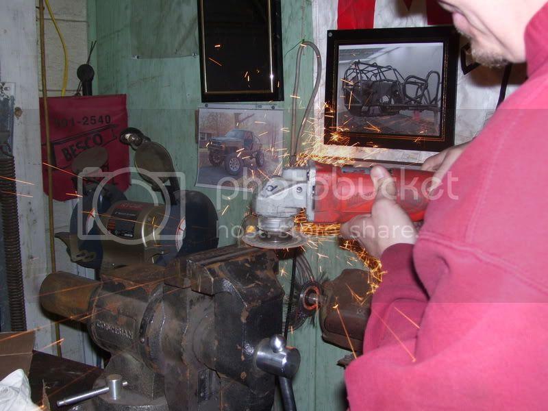

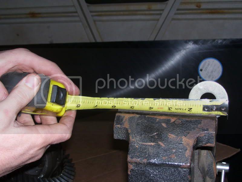

2.. Find 3/4 body washer
3... Cut said washer in half

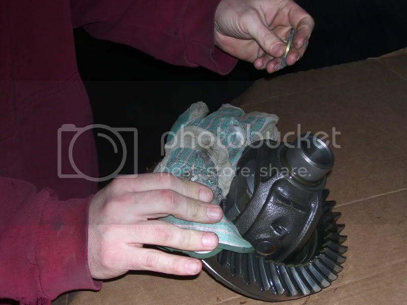

4... cover ring gear and insert half of washer in middle space..

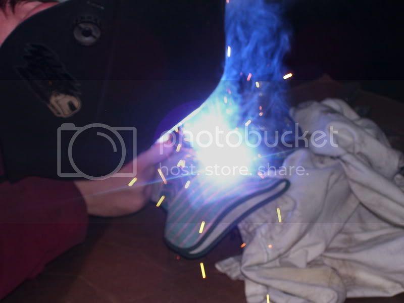

5... Weld the piss out of it... :flipoff1:

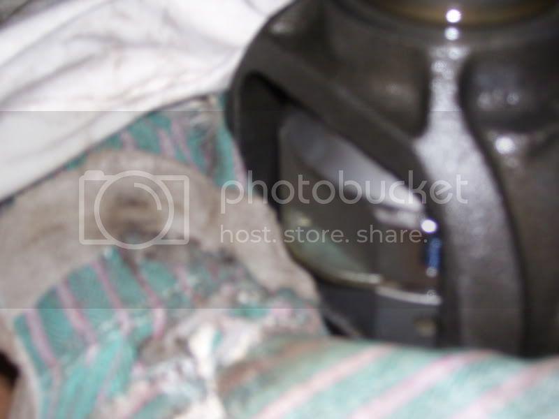

6.... Blurry pic.. but bonded.. Two holves to the washer and gap forced open..
Done..
