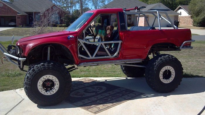

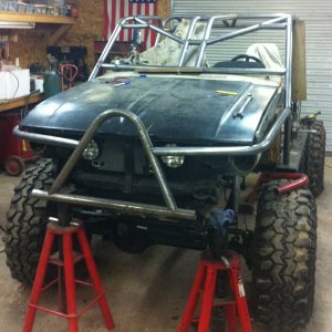

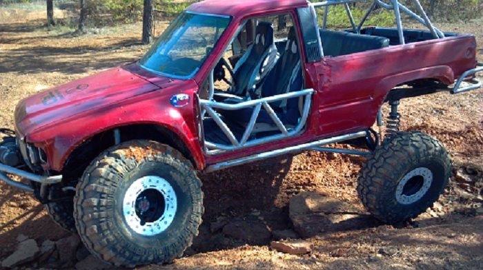

Thats what i did with mine. I ran a triangulated 3 link in the rear and tj coils, spool, 5.29's, bead locks, and the rear flexes great! the front has 5 inch springs it does well but not like the rear. Plans are for air shocks. I have been happy with it and think you should run with it.
