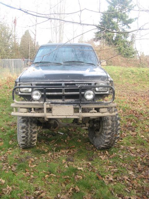

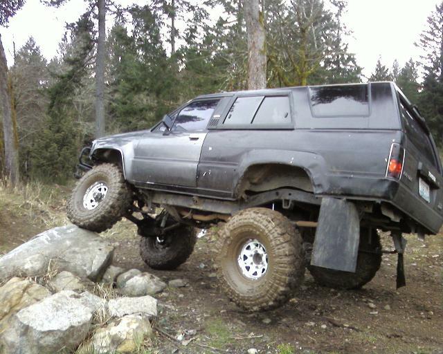

i'm moving on to another problem I think I have. Width on my front axle is to skinny and my truck feels very tipsy. i'm taking off the stupid body lift first but i used to have a toyota with wide offset 10" wheels and never felt like it was going to tip over around every off center off camber obstical. this truck is scary tippy swampers are rubbing on the front springs. i have 2" wheel spacers in the rear but nothing in the front. i need to decide if i'm going to just add wheel spacers to the front or if i should get some off set rims. can you all tell me in your experances what would be the trouble free way to go with this alteration. I would like this truck to be as wide as I can get but I wanted to know if there is any other disadvantages other then bump steer.
I have a high steer kit with a IFS box so I think the wider the better. Any thoughts?

Just run spacers in the front. Rims with less backspacing would be the best, but spacers are a lot cheaper and shouldn't be a problem if you remember to re-torque them after each of the first couple trips on them. :beer:

this is what i think i need to do: Get a wide Rear housing swap out my thrid and use the wheel spacers i have in the rear on the front. this seems to be the smartest most cost efective way to widin out my stance. if i need more i will have to get a different offset wheel. i like the idea of using a 44 and a 14 bolt but that creates drivline issues. i think the wheels i have now have a negitive offset and that is not cool.... :mad:
