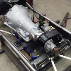

Well I've decided a crawl box is in order, I do WAY too much crawling not to have a reduction box ahead of my 205. I'm running a Th400 and should have a pretty salty lil engine ( however MOST of my ponies come in after 3000rpm). I've got my 1.96 lo range in the 205 for shooting hills and want a deeper option for the slow stuff
Here's my question--
231 to 205 ( mmm. How strong y'all reckon the 231 is... Will it live behind 700+ horses???
203 to 205 ( that's a big box to fit in my lil buggy)
I have both boxes here and am just trying to decide if the 231 will live, be nice to have the extra gearing over the 203 however... The 203 ain't breaking

I dont run 700HP, but I do have a mild 5.3 (cam/tune/milled heads) and I run the 231/205 behind my 4L60E and have zero issues with it. I have the chevy 32 spline input gear into the 205, so the crawl box has a pretty stout main shaft. I also put a 6 pinion planetary in it from either an early 231 or 241 (both were the same i believe). I have been running 42s on my truggy and have beat on it pretty hard. I run the 205 in low alot of the time, since I have 5.13s, but I have used the crawl box in low only. I really like the options that the 231/205 give me, compared to a 203/205. the weight is also a little lighter. I think one of the biggest failures is the case spliting apart, if it is not supported properly.
