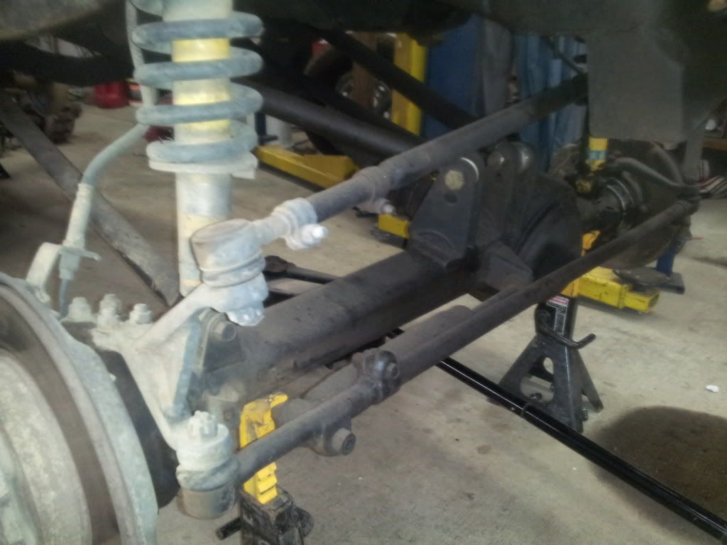

I'm a semi noobert when it comes to links but...isn't this a typical issue of a fully triangulated front 4 link? You generally have uptravel clearance issues unless you are lifted pretty high. You can remount the upper links outward and throw in a track bar to keep the axle in place and gain a ton of clearance.....my $0.02
