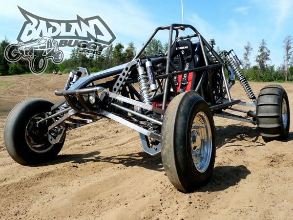

I've had this idea in my head a while about building a 4-wheel independent suspension kart/buggy kinda like the one in the picture below, but 4 wheel drive. I've got a 150 hp motorcycle engine laying around that I don't use anymore.
What I wondering is what kind of automotive differentials would be good and inexpensive to build around that would handle some jumps with around 33" tires? I know the mid-80s corvette diffs are D44 so gears would be easy to get.
What about a front diff? Would 4WD S-10 stuff hold up?

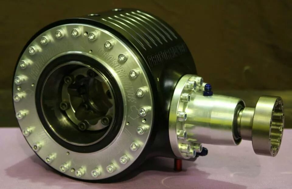

These guys are building a super narrow diff using dana 60 ring and pinion. Says they can accept 930 sor series 30 cvs and theyre only 1.5 inches apart in the diff. Proformance Motorsports is the company name.
