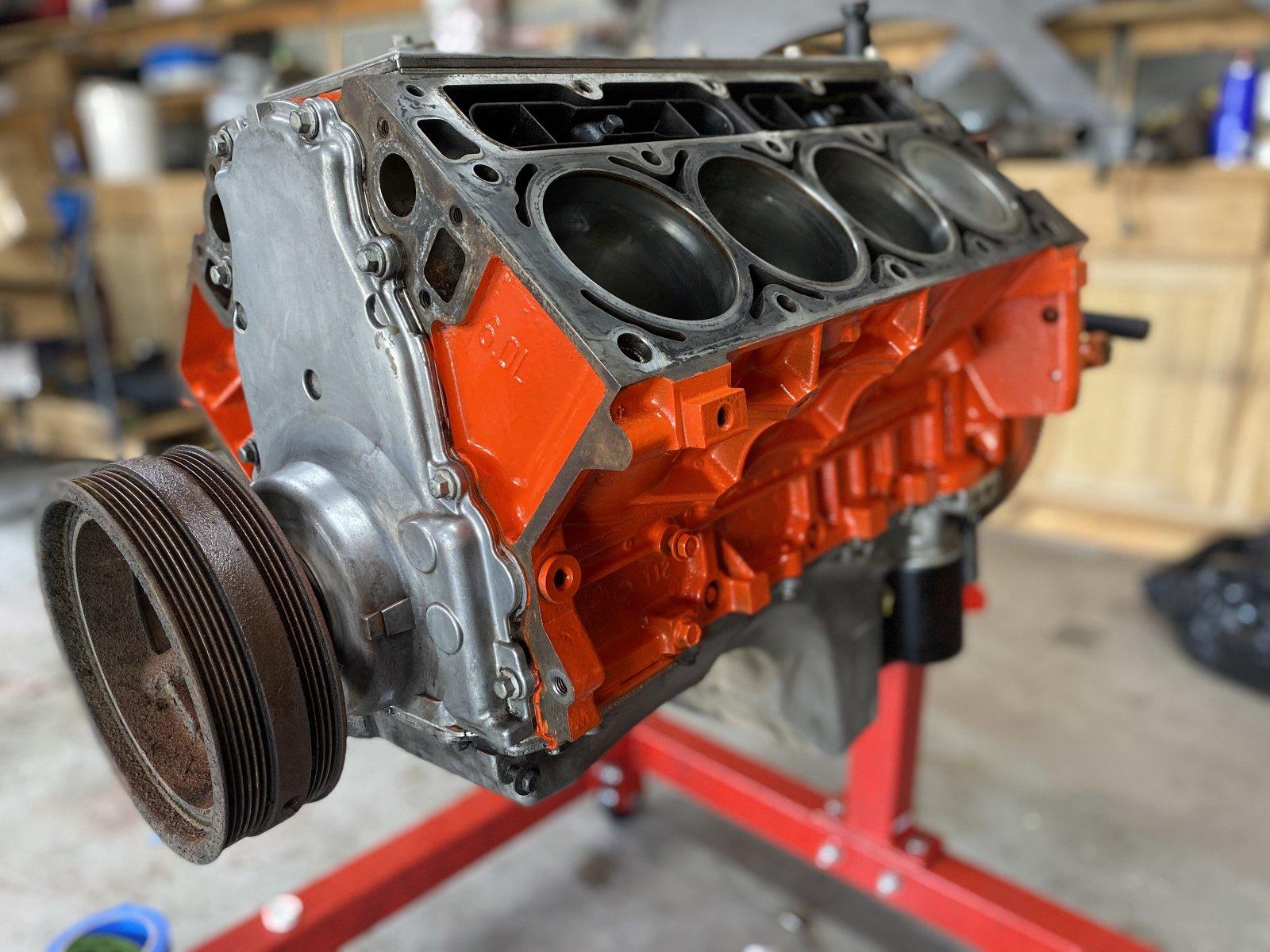

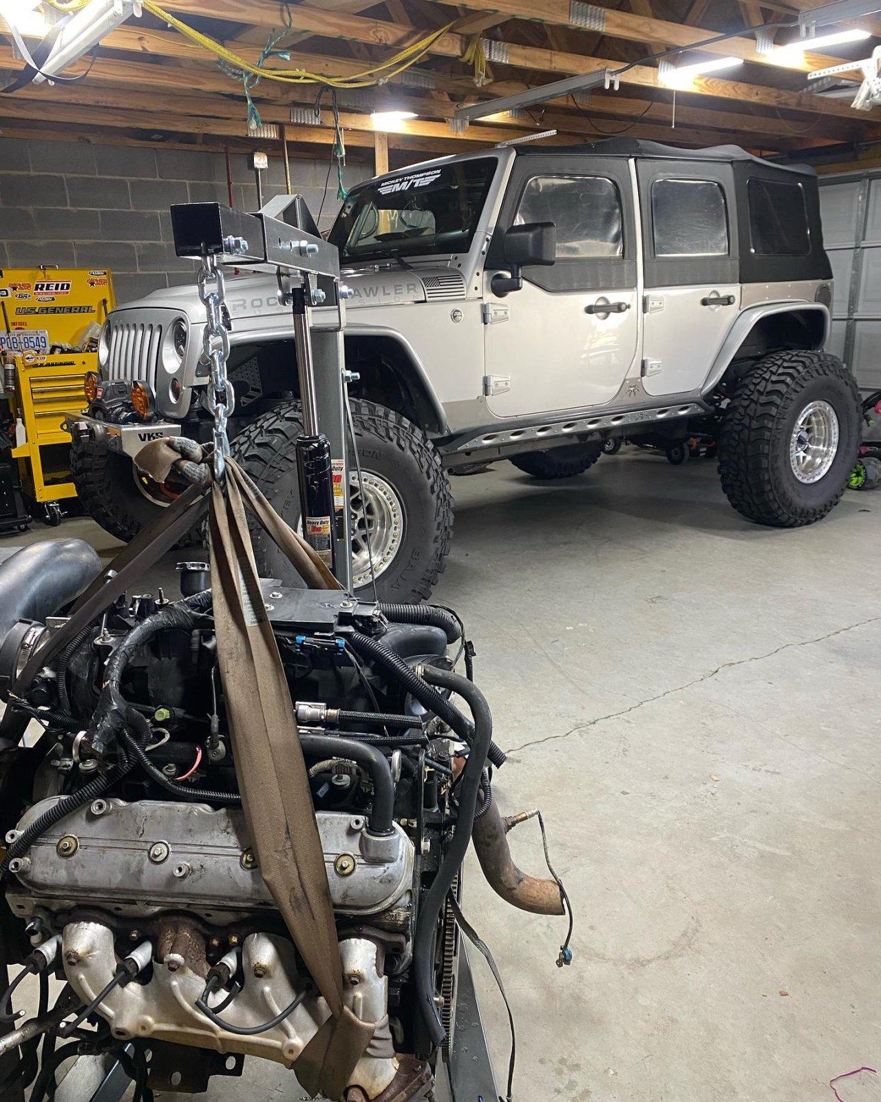

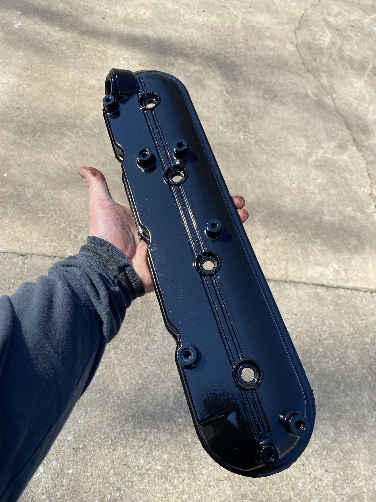

Lol I'm deep into parts now on the swap to waste any on the 3.8, I do plan to fix it so I can sell the engine and trans running together. I have a gen 3 6.0, 4l80e trans, ordered the Holley terminator max x, Holley 6.86 screen, intake with 102tb, and fuel rails, bbk short headers, BTR truck norris cam kit, new timing chain and oil pump, all gaskets, currently trying to decide which engine and trans brackets to use and I know I need the transfer case adapter and radiator but I'm getting there
