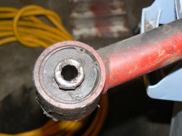

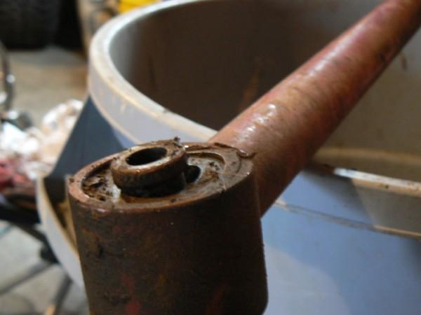

anybody ever have this happen with their Johnny Joints? Do I need to use a larger snap ring? The bushing came out past the snap ring on like 4 joints. On one of them the snap ring came partially out out??

I think your missing the washer that keeps the bushing in.:eeek:

As Sarg has stated...you are missing the washer that goes between the snap-ring and poly material. You are missing parts that are designed to be installed :awesomework:

I thought it was just my eyes playing tricks on me. definetly a needed part.
I am not the one who assembled them..but that would make sense.. I guess I'll go about ordering the needed parts..lol
