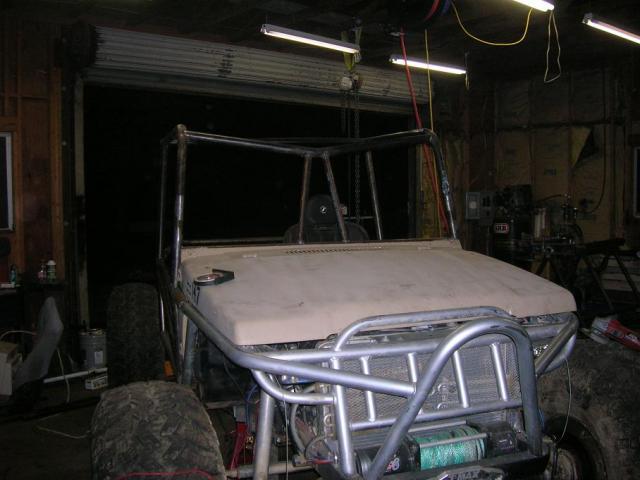

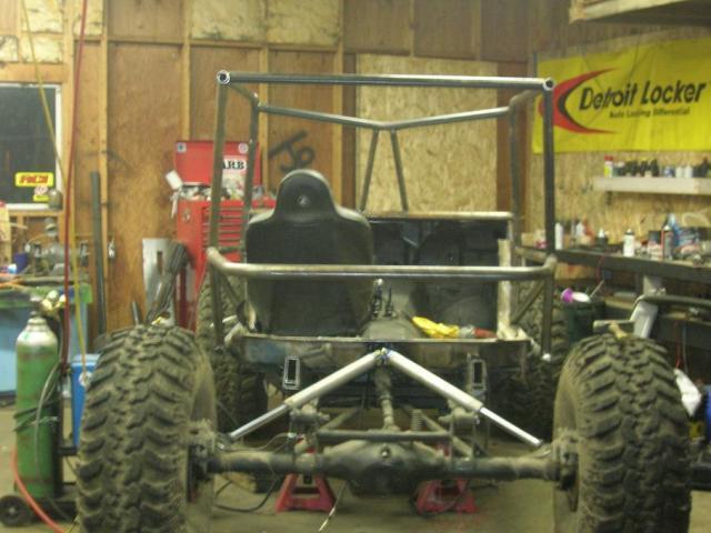

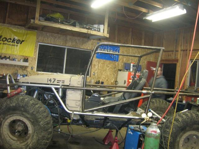

Started bending up some tube today. Got more to go tomorrow but this is what i got done today,
Edit... Just lookin at old pics and it kinda looks like my old sami from the front. Wasnt what i was tryin to do....oh well.:haha:

Giterdid. :awesomework: Are you changing up the design completely, or just gonna add more bracing?
Edit: Nevermind, looks like a completely different design, you lost way more tub this time. :awesomework:
Pretty sure B-rad ****in' witcha!! :; Looks really good Brian!:awesomework: I have only one question; why the pissed off eyebrow look?? And shouldn't the B pillar tie in bar have a little rise to it to keep from crushing? Or are you gonna brace it from below? (ok, two ?'s!!!!:redneck:):D Does look good man!!!
That windshield bar seemed to be the only thing Jp was worried about on the whole sami:eeek:. He had to have the pissed off look. The b pillar is still getting an X brace in it. Im going to build it stronger than before but seeings how i cant drive it anymore it will never be on its roof again.:haha:
:redneck: Cool---I was just abit concerned that in the event of a roll, the Bpillar bar could crush in abit--why not do an upside down V back there, and tie the lower legs to the lower tube work???

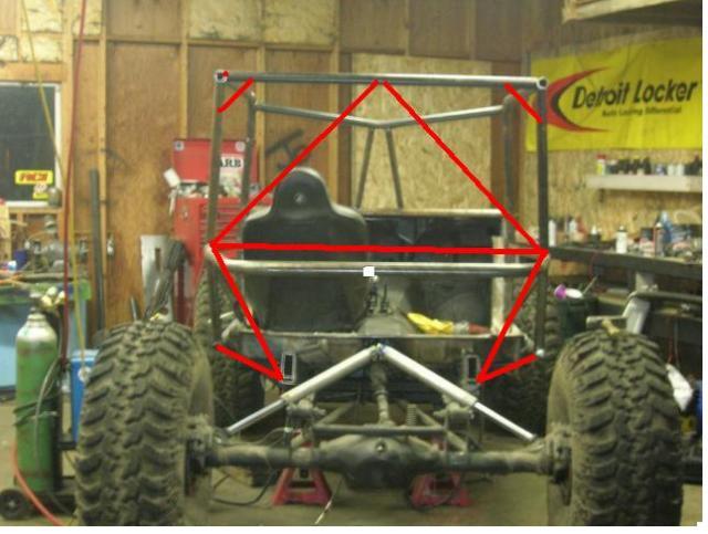

Guess Im not sure what you talking about....put microsoft paint to work....show me.:redneck:
Brian, I know its more work but you should put all your nodes into one spot if possible.
For example your door diagonals. They are below the intersection of the B pillar and the door cross tube node and above the intersection of the A pillar and rocker tube node. If they all fully intersect its stronger.

Well, let's see if I did this right....yup, I did...something like this...Of course, with a few more corner braces in there, but you get the idea...
Im not building a jungle gym kev..... An x brace is all thats going inside the b pillar.:redneck:

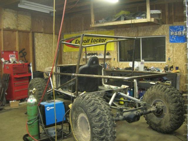

What's up with the rear shocks? I assume that's not where the top mount is going to be?
:haha::haha:No thats not where there going. When we cut off the frame we just laid them over to get them out of the way.:haha:
