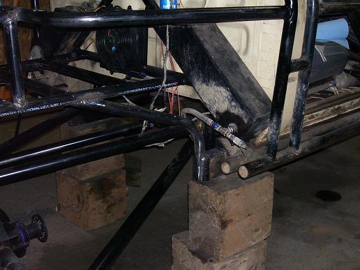

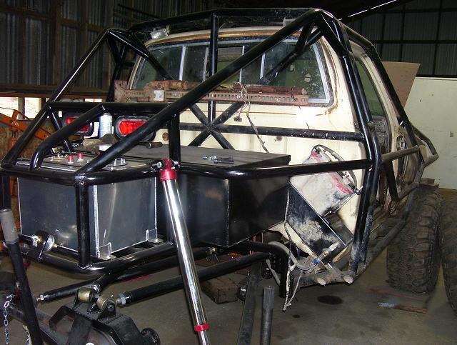

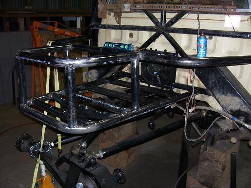

just a lil pipe and link work

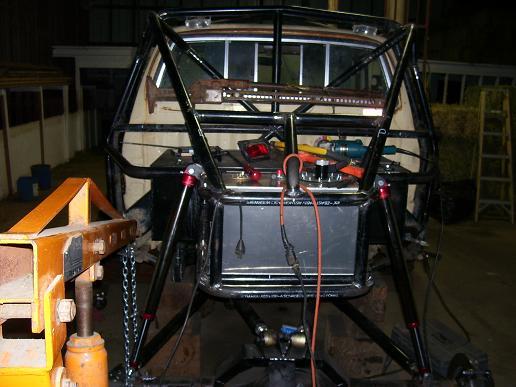

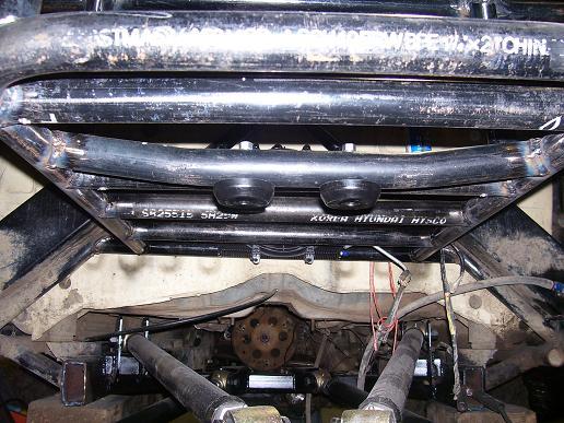

pulled it all apart to weld it up and added cross braces to mount my tank and box too. Also added a bar to mount my center bump stops too also:redneck: .

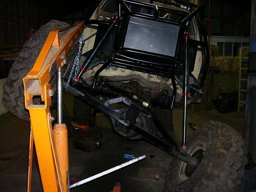

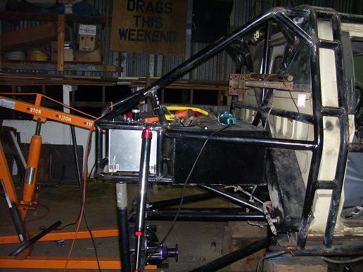

the tank should be pretty well protected I hope:redneck: , if not I will have to due a lot of cutting to get it out:booo: .

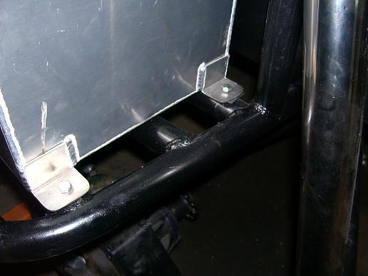

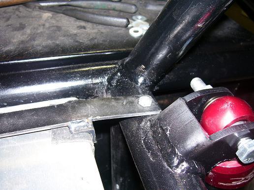

bolted the fuel cell down using the 4 (weak looking) tabs with some rubber strips between the mounting tabs and the bars. Also made a clamp style brackets and bolted it down from the top. I have heard that the stock tabs just do not hold and will rip out in trail/rock rig.:D

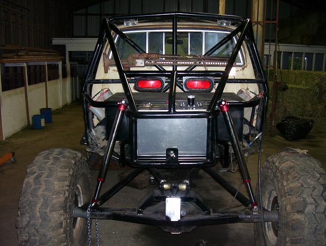

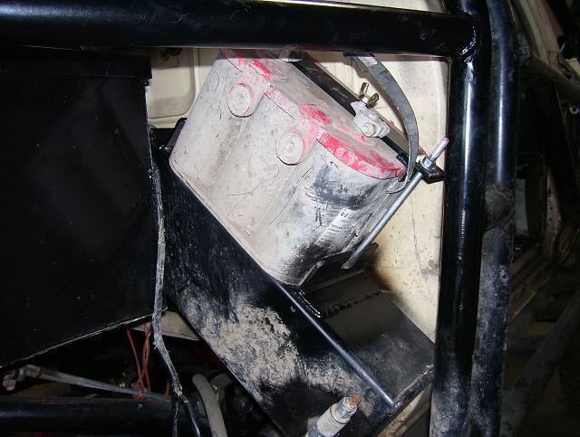

finished building my battery boxes, they are still at about the same hight as when they were in the motor bay.:kiss: I also bolted the tool box down and added a piece of .25" UHMW to the inside of the box to help protect the bottom from getting beat to death from parts. Also added the brake lights.:flipoff:

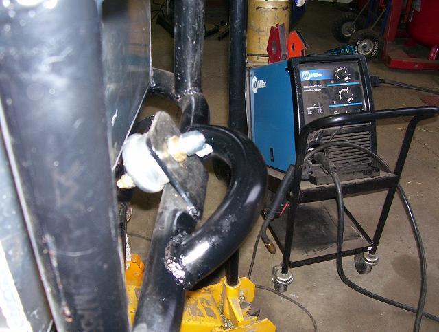

added a kill switch in the back and will also add another in the cab so I can get to it fro the drivers seat. Placed a lil pipe around it to protect it from rocks and what not. The wires cannot touch the tank even if it gets hit and bent over.
I don't know...that switch and little nerf bar look pretty damn heavy :flipoff:
Binder said:
Looks good.....That flat bar on top of the battery isn't going to come loose and short out the battery is it?
x2 or the battery will just fall out of the bacK? :redneck:
hope not, its tightend down real snug and locktited in place. That could ruin my whole weekend :mad: :flipoff: .

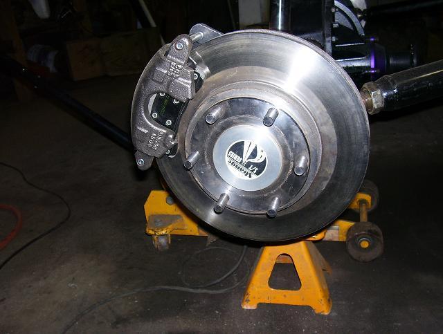

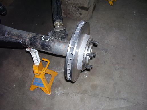

started working on my brakes, using the rotors of a 77 chevy 3/4ton 4x4. My axles have screw in studs so I was able to mount the rotor to the inside of the axle flange. Which allowed me to mount it off the bearing race.
