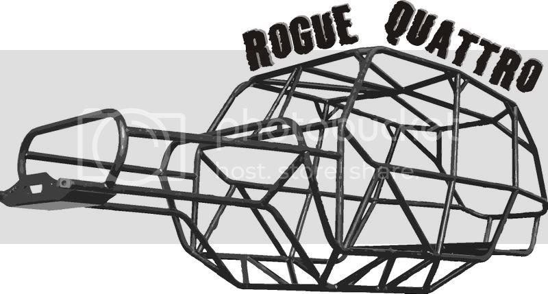

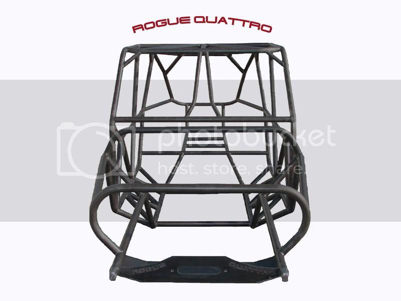

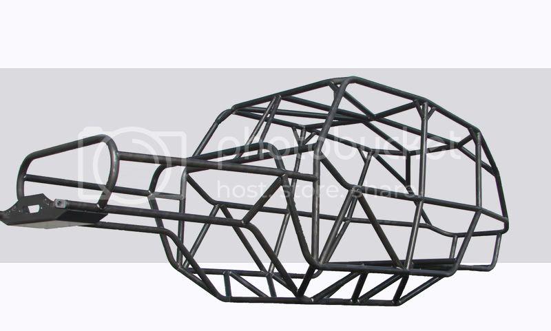

Introducing our New Production 4 Seater Chassis.....dubbed the "Rogue Quattro"
The Rogue Quattro chassis is fabricated from of 1.75" x .120" DOM tubing with 1.25" DOM tube gussets to add strength in key areas. The Rogue Quattro chassis is set up to use a FJ cruiser hood and grill. The 'Quattro' can accommodate 4 passengers with extra storage room.

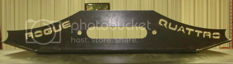

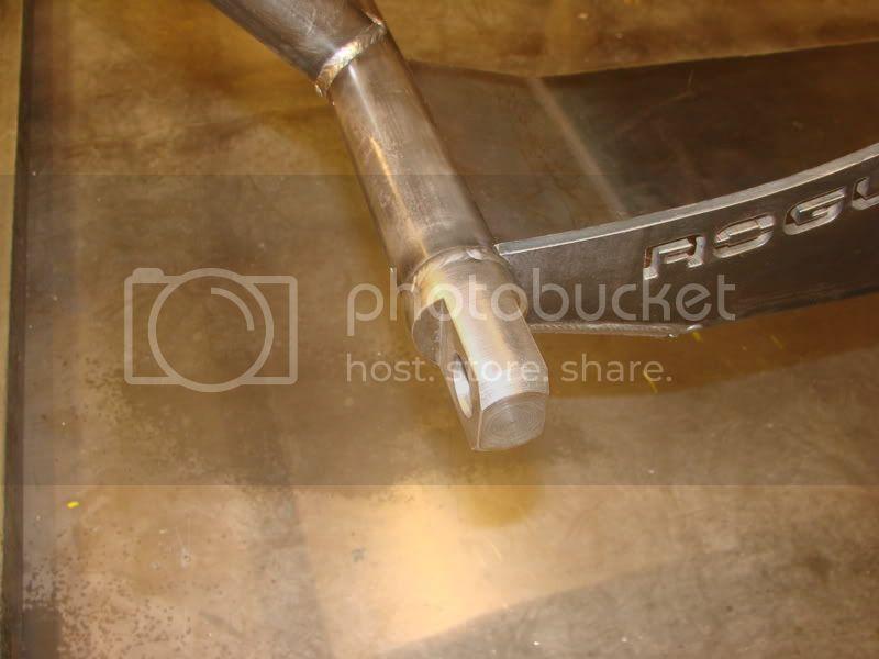

A front winch plate is included with the chassis. The winch plate is CNC cut from 1/4" steel and then formed in a press brake for ultimate strength and fitment.
Also included with the chassis are two front tow point inserts. Machined from 2" steel round bar they allow for a solid tow point for the front of the chassis.
Give us a call at the shop if you have more specific questions. A two seater version will be available soon....

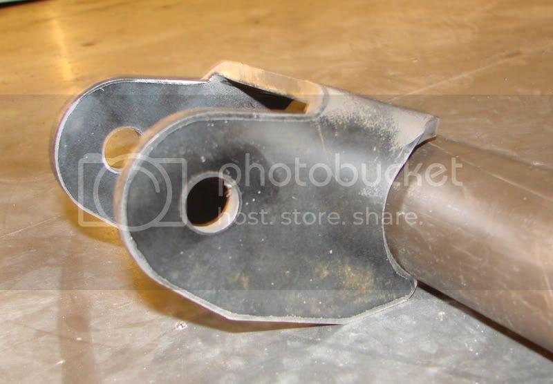

The chassis is designed to be easily assembled with our bracket line.

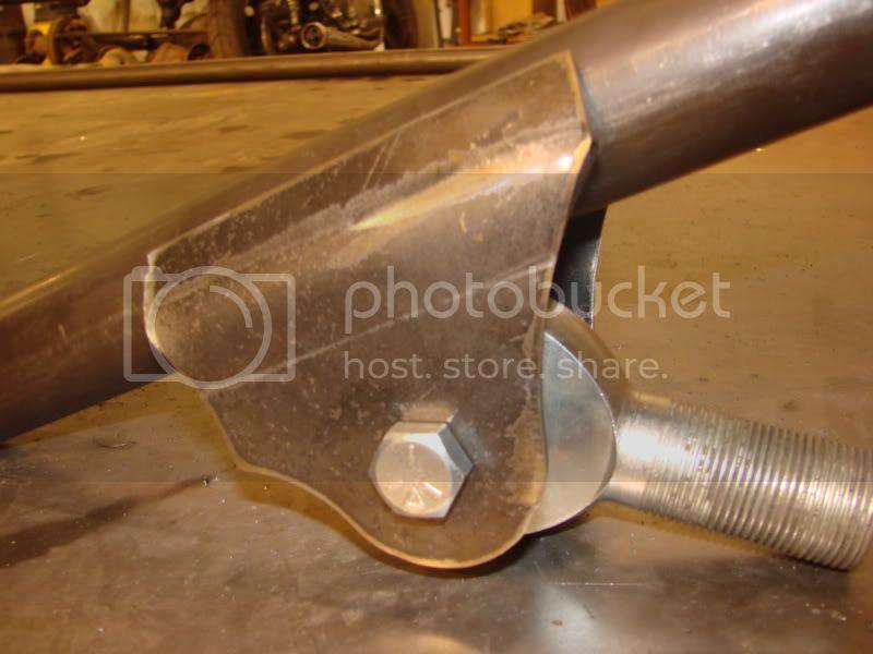

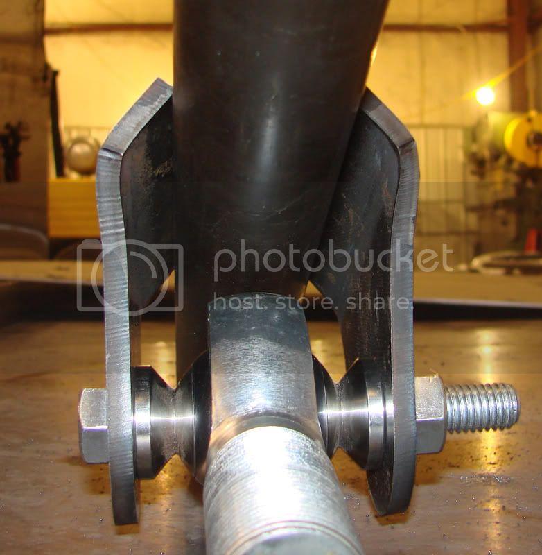

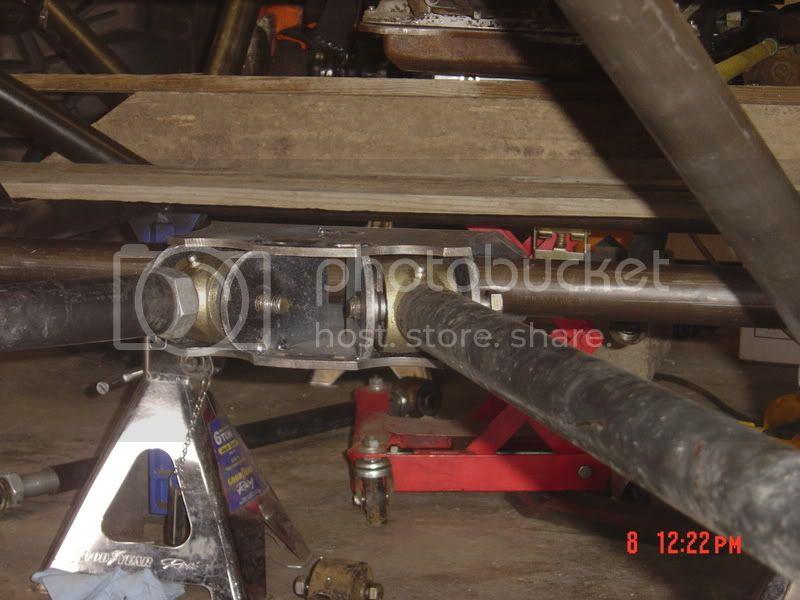

This is our lower 4 link bracket. This allows for an easy assembly of a triangulated lower control arm setup.

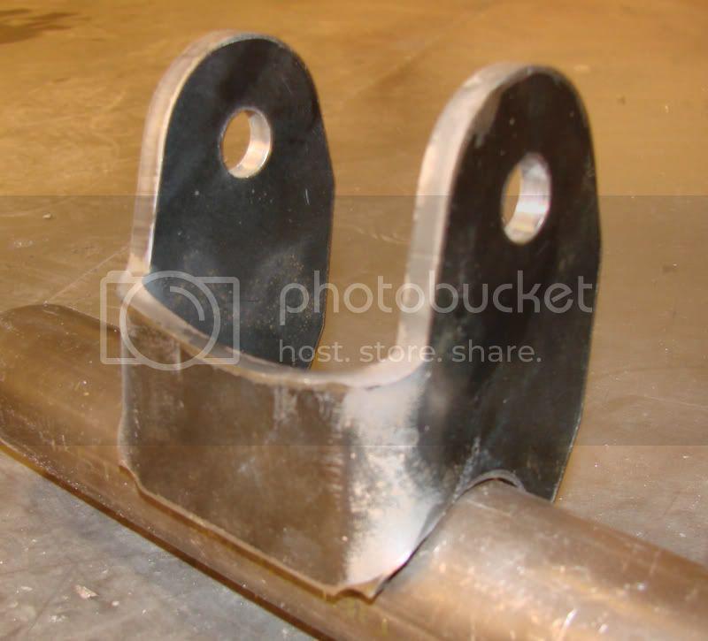

Here's some of the brackets specifically made for our chassis, however they could be used on other applications.
All CNC cut from 1/4" steel and then formed in a press brake...
These are for the front lower control arms.
These brackets have a 1.75" Radius on the bottom. They fit perfectly on our subframe assembly for an easy upper control arm bracket.

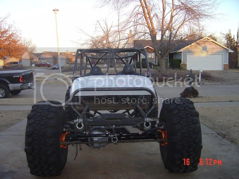

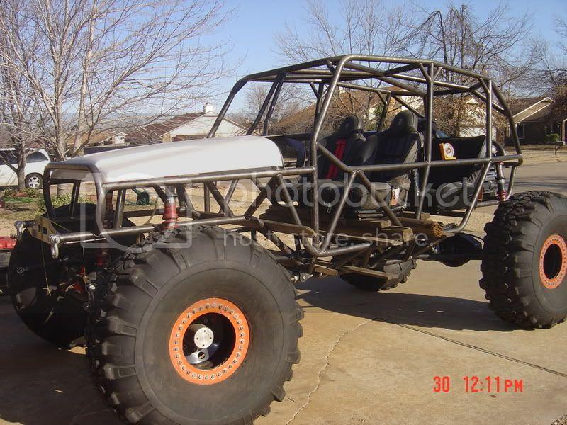

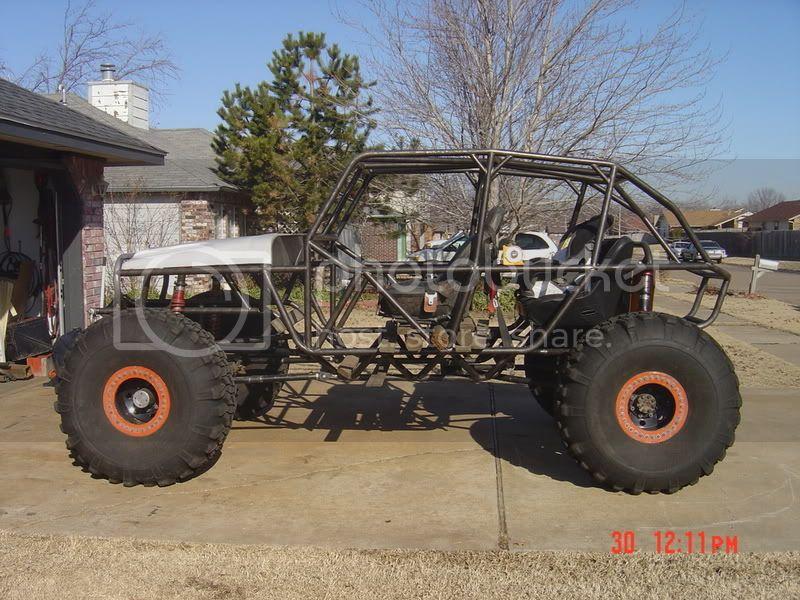

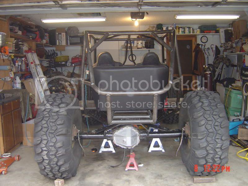

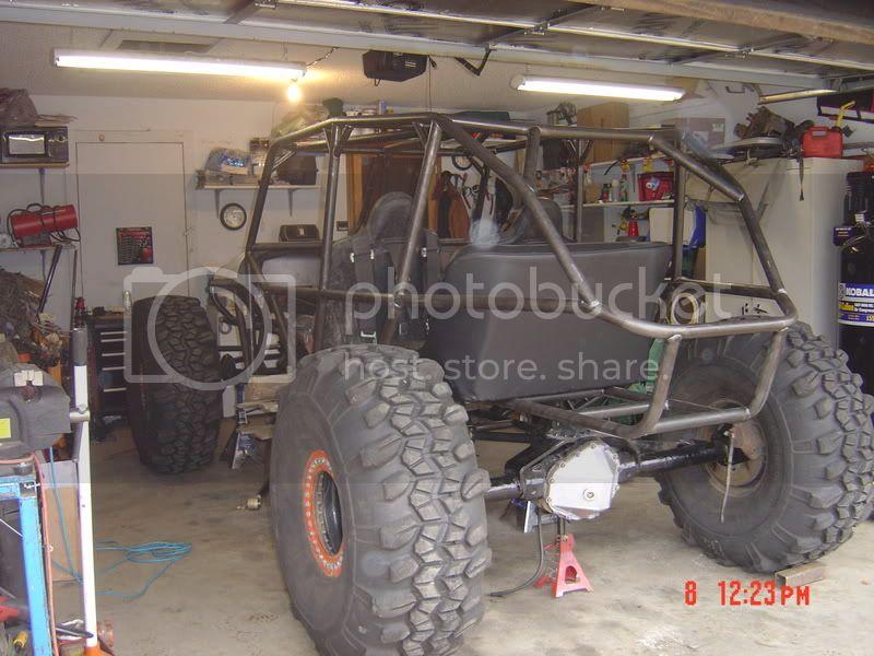

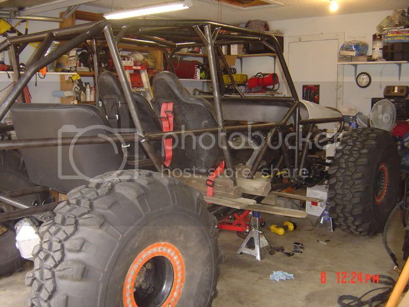

Chris sent me some pics of his progress......
He said these were taken at full compression and 114" wheelbase.

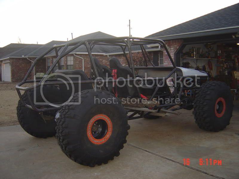

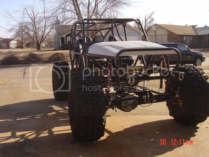

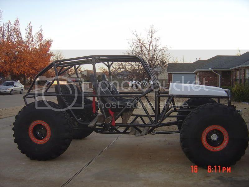

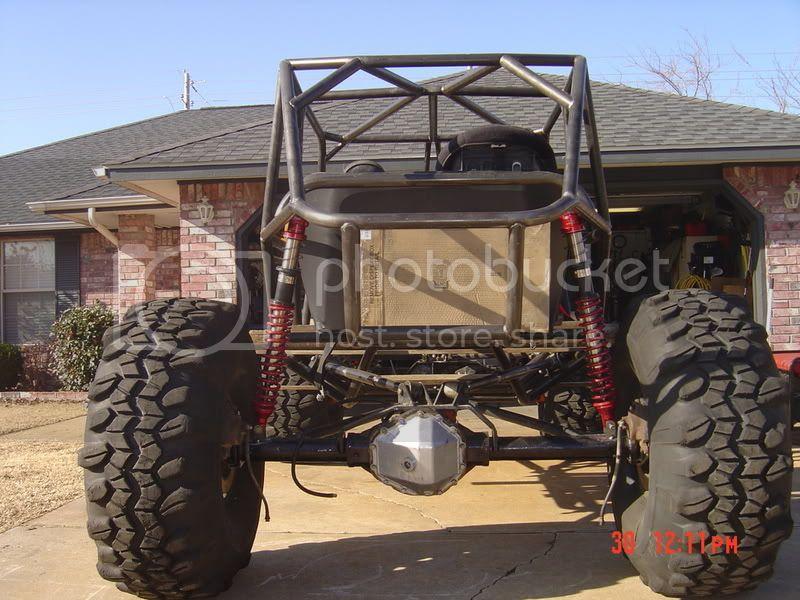

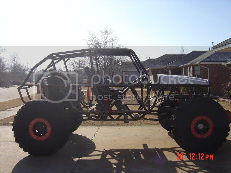

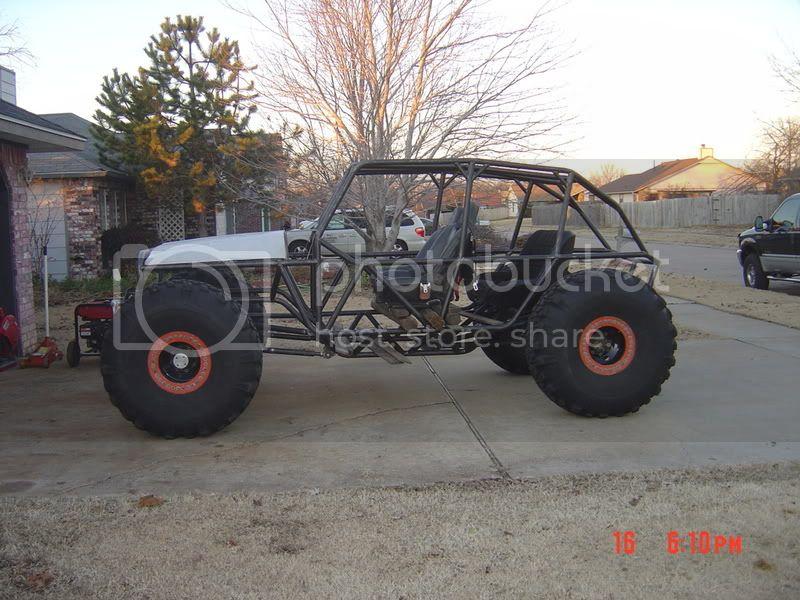

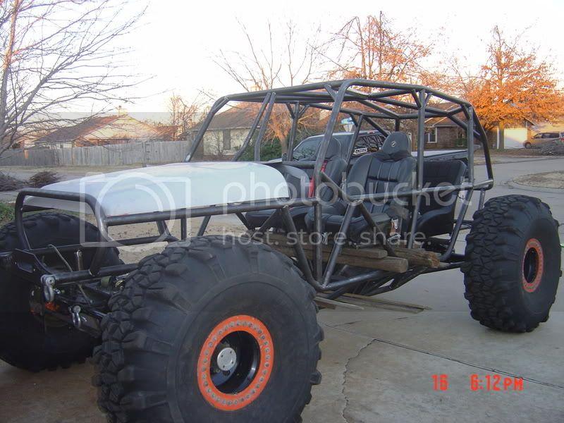

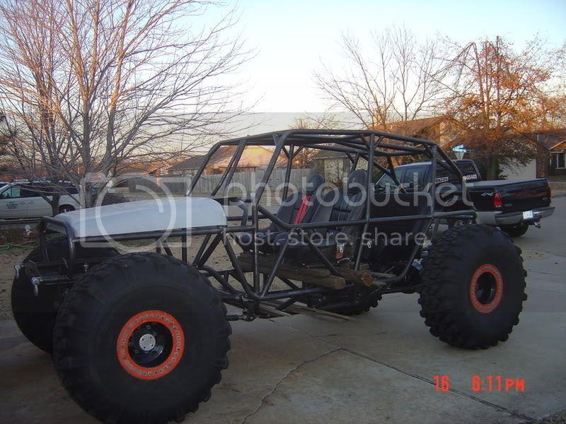

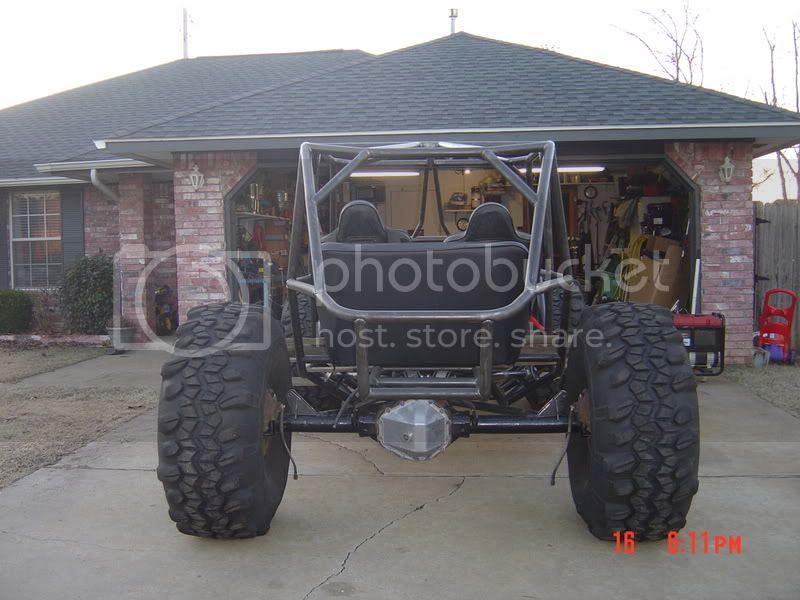

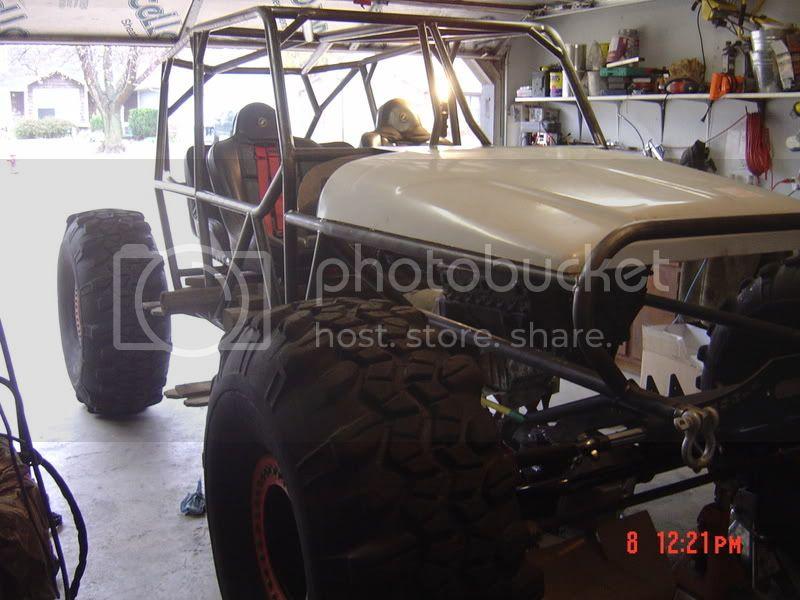

The owner sent me some more progress pics on the chassis.....
Sitting at ride height and 114" wheelbase
I believe he told me it's 78" to the top

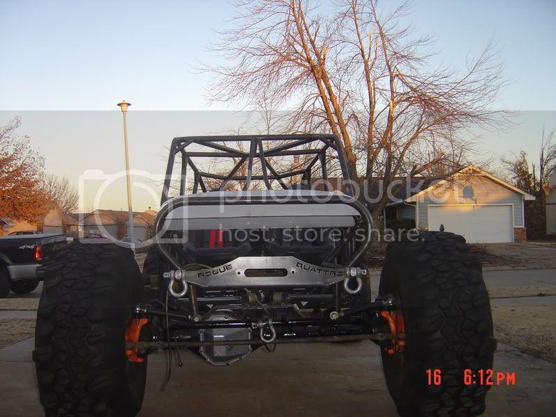

Just a little update...
Chris brought it back to us to skin it out for him. We skinned it out using combinations of .065" & .100" aluminum. Including a transmission tunnel with a seperate T-Case cover, firewall, floor pans, rear seat enclosure, side skins (Program save on the CNC table for easy replacement), roof, dash, and a cowl formed from 14 ga. & 11 ga. steel.
We also added a small stinger to the front end.
He picked it up and painted the chassis, now he's bringing it back up here for us to install the motor this evening.
Then he'll be taking it back home to wire & fire it!
Pics coming soon....
