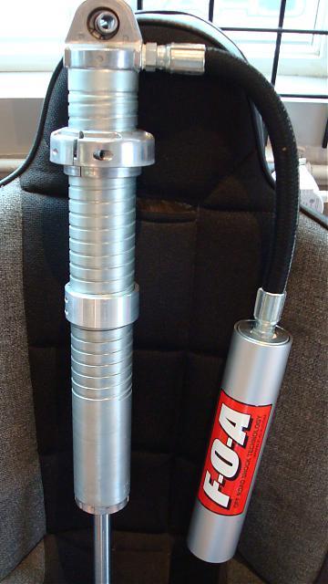

FOA 2.5x14 coilovers & bumps, four links front and rear

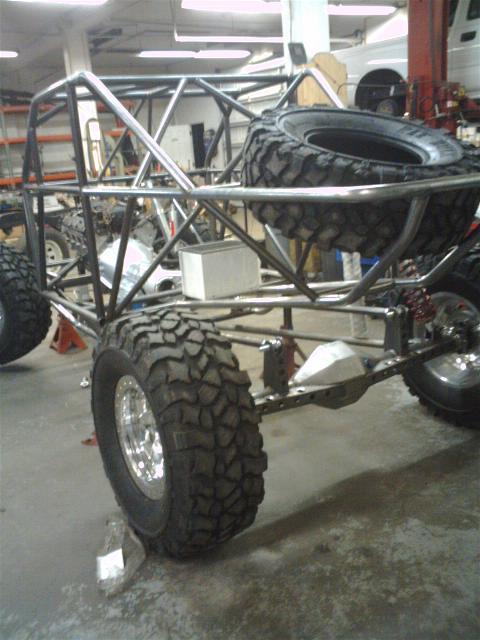

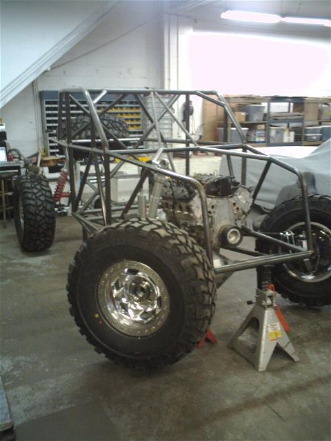

Got empty trans and t-case Friday, so had a short day Saturday and some time today and got some done, engine/tranny/tcase set in and mount made up, rear axle and links (1.75x.375 chromo lowers, 1.5x.250 dom uppers) all done, front axle in, front links done (same as rears), knuckles assembled, floor patterns made, front and rear coilover mounts started and battery tray built. Sitting at full compression (69"+6" uptravel = 75" ride height w/20" belly clearance)
approx. 42* turning at full bump
