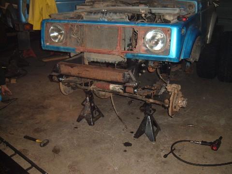

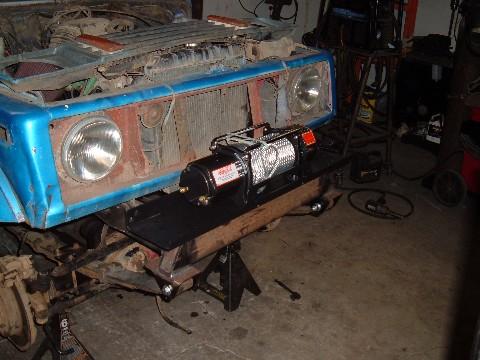

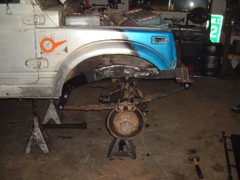

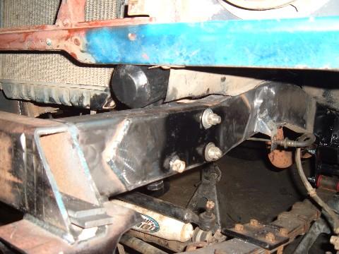

did it last week all i need to do to it still is a front drive line :cheer:

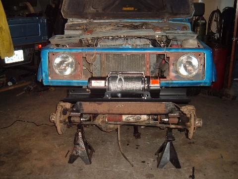

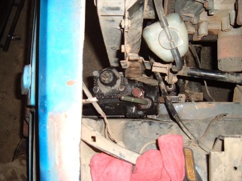

ill get more pix of it finished but this is what dad got him for x-mass :cheer:
