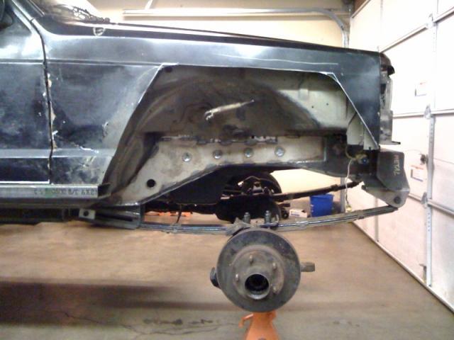

This is what my front leafs look like. Loaded now, im about 2" higher than stock coils, with 4.5" WB stretch. similar setup could be applied to a toyota to slamm it.
