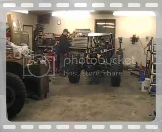

Here's a dumb little clip. I had the helmet on cause I was ready to go fast but no one else was!
Few problems:
1. wiring at least one crappy soldered joint came apart. Also fan didn't come on
2. steering leak - the orbital is leaking out the front where the column attaches - I have several that work now but I think they all do it. Is there a seal there or what? it's coming up the column and out near the wheel, not bad but not acceptable
3. cooling system?? Blew the lower hose off after a trip up the street and back. The lower hose pressurized? shouldn't it be vacuum? the upper was warm, the fan never kicked on and my crappy guage never registered. The fluid was warm but not boiling hot. I put a new pump on, new t-stat and all hoses are new. I think the system was fairly well bleed and the cap seemed to work cause it has filled the overflow before. At first I thought maybe I put the belt on wrong and was turning the pump backwards but it's on right. Bad radiator? or did it get hot and I didn't know it?
The fan is still controlled by the factory taurus computer and it has turned on once before but not long
It was a blast though!!!
braking sucks so far - we didn't bleed it enough
I've got a corvette MC and 3/4ton chevy brakes all around
think it need residual valves on front and rear?
proportional valve?
which res to front/rear? or does it matter
acceleration is good so far
went right thru the gears in low and then again in high
probably only got to 30-35 in the dark with bad brakes and no lights
