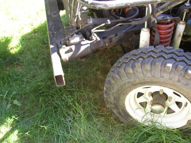

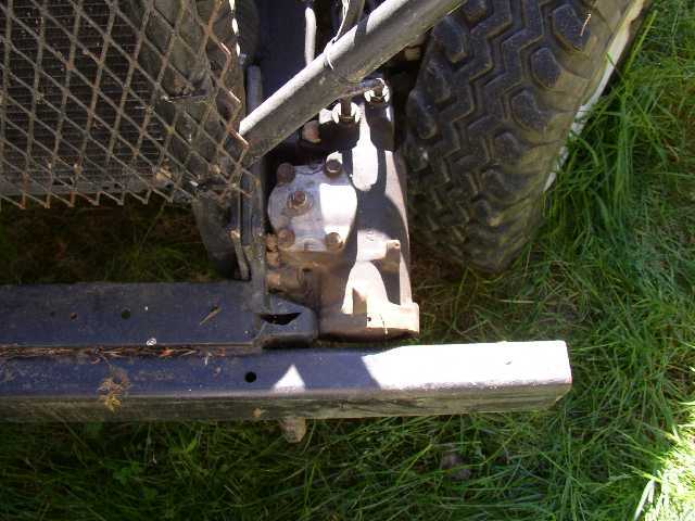

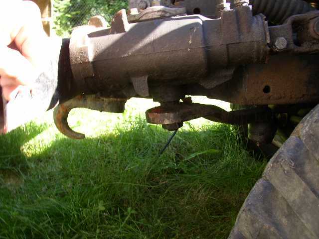

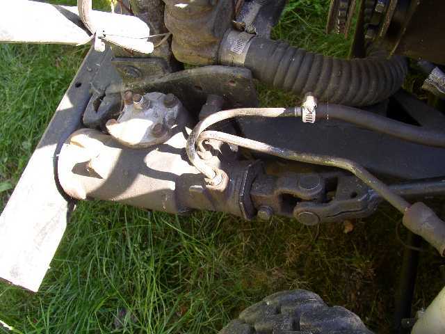

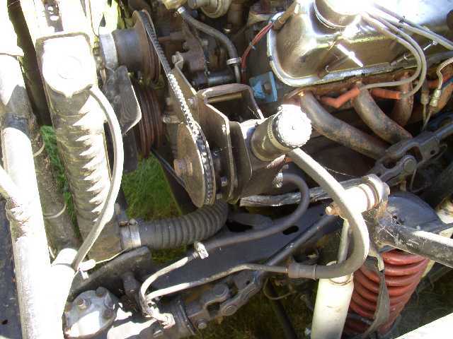

theres an easy and more importantly cheaper way to put PS on a bronco. On our race rig we use a saginaw box from a 2 wheel drive chevy truck(mounts on the outside of the frame ) you do have to make up the steering shaft and you can get brackets to mount a saginaw pump from a van with the 351w. I will take some pics of the mount since there is some fab work needed to the frame to make the box work.
ya, that seems like a lot of work though, btw, I ordered up the joint you sugested before in another thread and it was way to big at the splined end.:mad: are you sure it's 13/16s? or are you using a different steering box?
yea its a little work but considering you can do the whole swap for $100-$200 and spare parts are really cheap to me it makes it worth a day of fab work. when you consider the cost of a saginaw box over the ford unit after you break or wear one out it becomes even a better deal. The early boxes were the 13/16 (uses flare fittings for the hoses) later one are smaller and use o rings insted of flares. you should always measure before buying though since there are a couple of differant sizes. anyway heres the pics. let me know if you want to come take a look and we can set something up.
