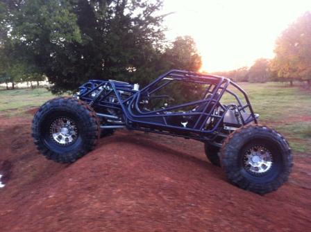

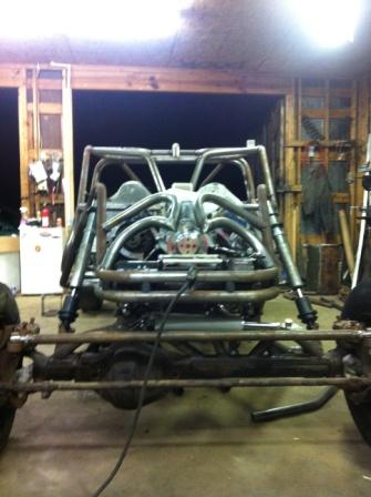

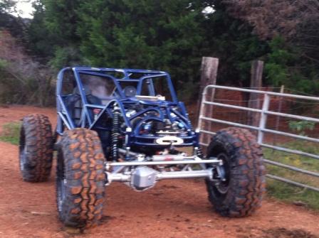

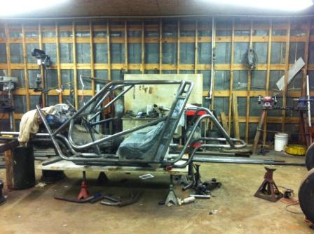

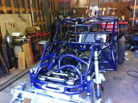

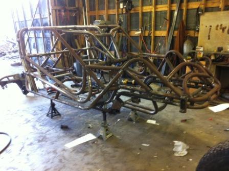

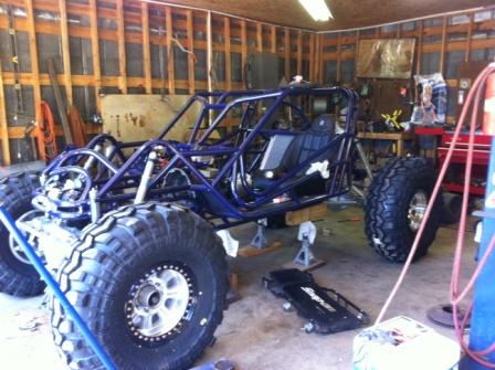

Musselman Fab Mopar buggy build
Specs
Dodge big block 400 stuffed with a 440 crank and rods small cam stock 452 heads with professional products fuel injection
727 torqueflite with manuel vavlebody 2000 stall
dana 300 with big shafts front and rear (which is not holding)
chevy 60 front 4.56 spartan locker yukon shafts bobby long u-joints 3/4 ton rotor and calibers
14 bolt 4.56 detroit 3/4 brake
14 fox coilover front 16 on rear 3in bumps on front
psc steering
wilwood master and pedal assembly
xrc winch with rope
powder coated illulsion purple
wheel base 118
