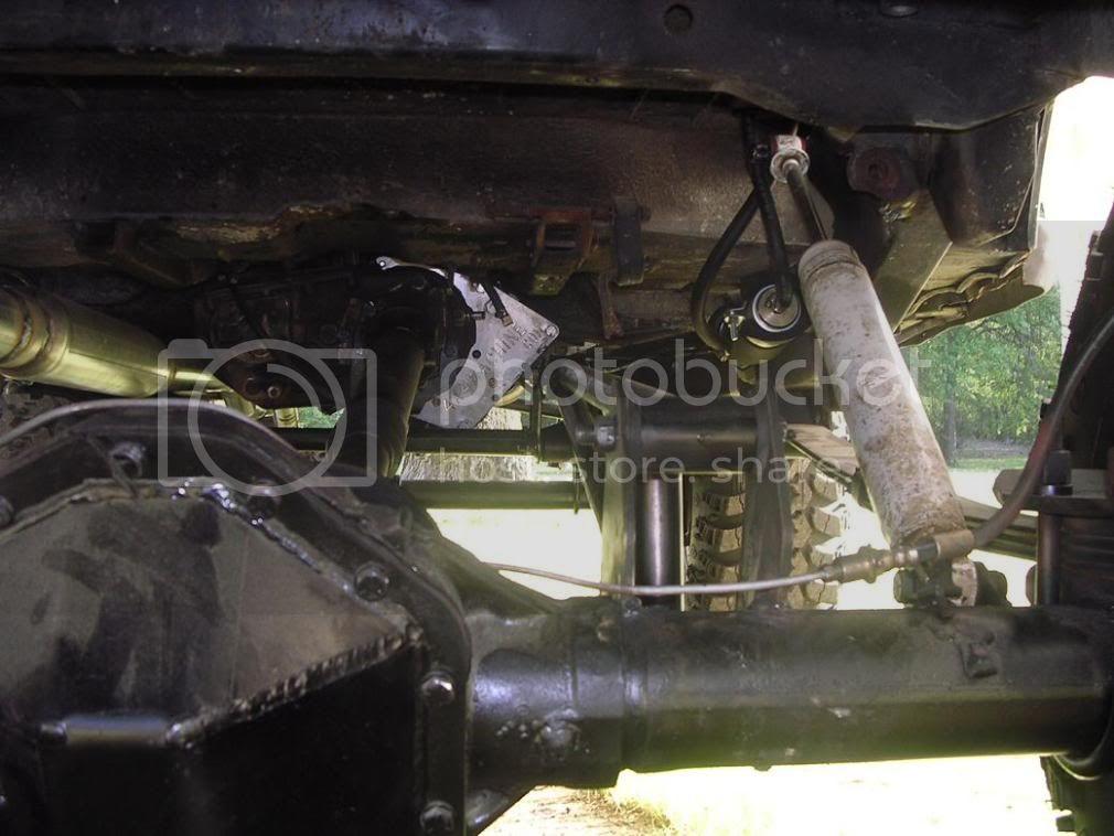

P I made a horseshoe looking bracket that monted to the 300 output housing bolts on the case and then below the case made a 90* bend and used the same
GN poly mount that the trans uses. I will check to see if I have a pic of it. found one. Not a good one however.
Thanks for the pic, Im thinking Im going to poly mount it with bushings at the chassis so its set up in the same manner as the engine... Ill have to live and learn on it and see how it works out.
Joes buggy has a stock mount, then the Roark Atlas mount and he hasnt blown it apart ... I mounted the engine in his the same as I did in mine. Im just not down with the Tcase hangin off the back of the tranny mount, no way that will work for me. laughing
Yeah, I've seen too many broken trannys where the tcase bolts up is why I did mine the way I did. I am going to Cut the bracket on the short side so I will only have 3 of the 4 bolts on the back plate so I dont have to fight holding the plate while putting the bracket on. I think it should work.
Im going to go on and use the factory poly mount on the bottom of the adapter, that will hold everything "up" and then the bushings will keep the twist to a min. Everything will be able to move a lil with the poly's on the engine and tcase so its not a rigid mount , but adding the polys and the tranny plate will make it firm enough out back "IMO" to keep it all in check.
