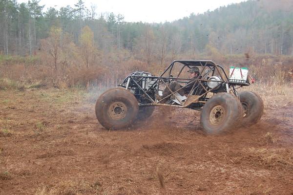

I cant remember the guys name ( Im terrible about that... ) but as I recall this thing has a turbo on it and its all yota parts correct ? What kind of ends on the suspension does it have ? I assume its 3link front and rear any other pics of this cool lil contraption !!!???

No radiator and its all contained in the chassis too as I recall ( cooling ) :dunno:

His name is Cassidy. It does have a radiator in the back. It has a turboed 20r on propane. Toyota 5 speed to a sami tcase. Toyota axles, homemade DE 6" rams. I know the front is a 3 link w/ heims. I think the rear is a 4 link. He may be at the ride at the end of this month, but not sure.

Any particular reason for the sami case ? :dunno: Thanks for the info Travis, hope he show's at that ride I want to look that thing over some more ! Its very cool thumb.gif

I think he used it for the offset rear output.

Sammy case is light, small, divorced case, and outputs are both on passenger side. :dunno:

You dont by chance know the WB on it do you ? It was on 39.5 Irocs as I recall but I could be mistaken....
You might as well rattle off any information you can think of.

Ahhh , I bet your right... I forgot about sammi's having offset rear axles... good call white guy.

Wheelbase is around 102", 39 irocs.
