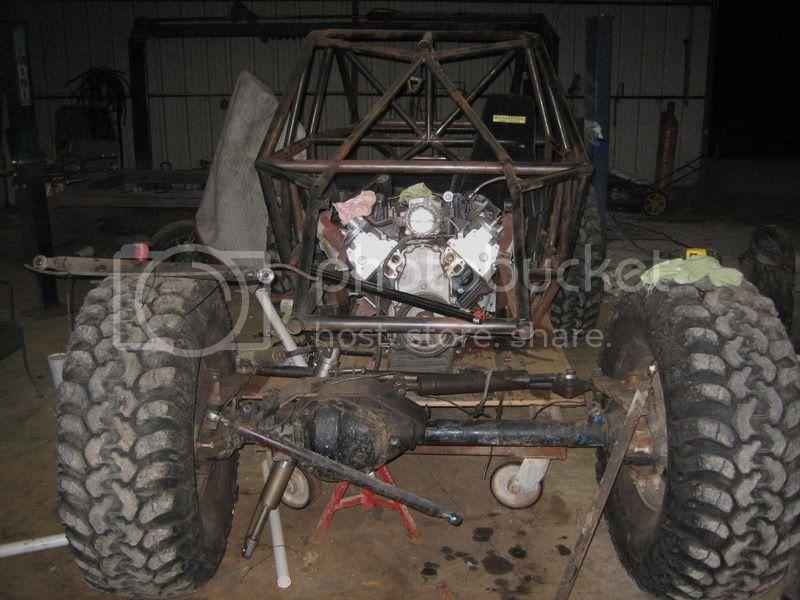

Where do the ratchet straps for the subwoofers hook up? And unbolt all that crap from the front axle before you drive it, looks like a bowl of noodles.

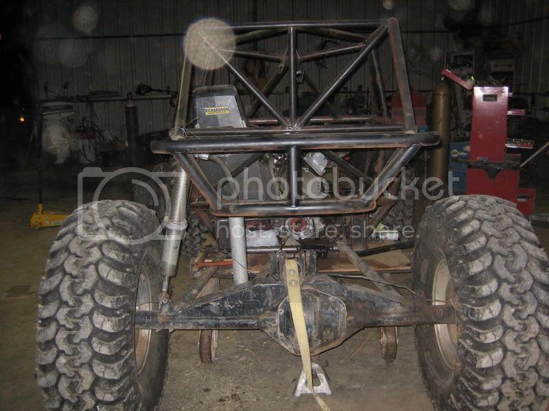

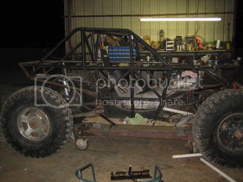

chassis is a mix of 1 3/4 .188, .120 / 1 1/4 .095 cromo

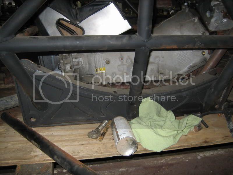

sub frame is mild steel 3/16 doubled has internal ribbing where the chassis connects

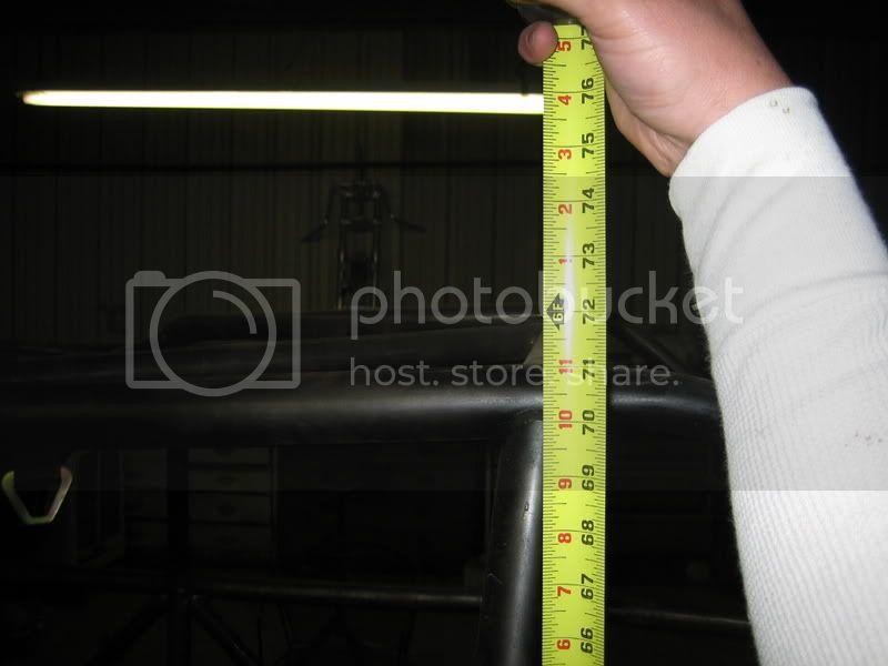

46 1/2 at its widest point internal measurement
right at 5 10 to highest point of cage at ride height
20 inches of belly clearance
shooting for 8" up travel in the front at least 10 in the rear
coil overs and air bumps all the way around
enough radiator to keep it cool no matter how hard or long i run it
minimum of 20 gallon fuel cell
full size spare on the back

Sounds like one hell of a rig. ;)
