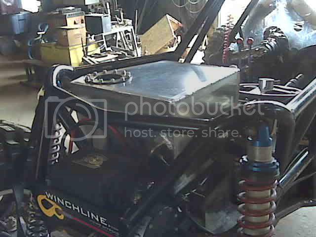

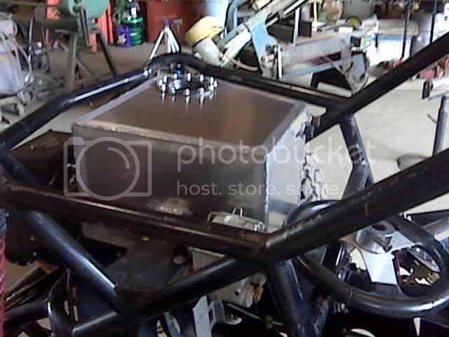

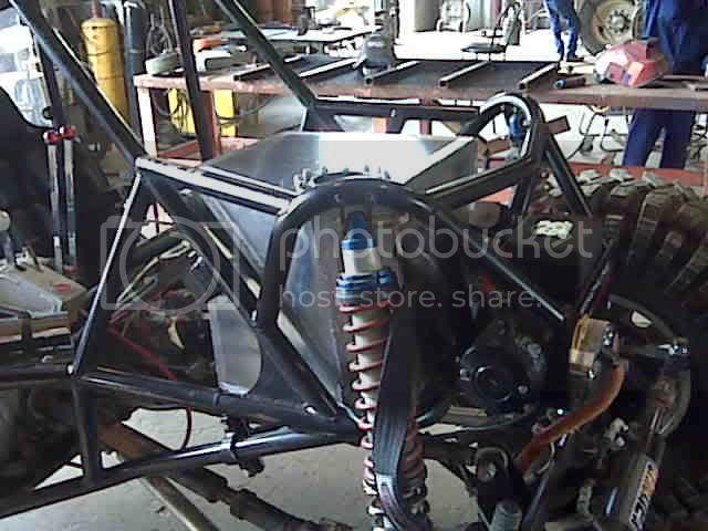

With the upcoming KOH qualifier at Rausch Creek I had to figure out something on my fuel cell. The buggy has a 3 gallon cell and that obviously will not cut it, I would be lucky to make one lap on the course. So I got the name of the local welding shop that built one right before KOH for David's buggy. They did a very nice job on his so I loaded it up and took it down to them. I already knew where I wanted to put it. I have a an area to the right of the floor pan over the 3rd link and driveshaft that I could use. What they came up with is a 12 gallon cell that slips in and hangs down between the floor pan and outer tube. It comes across my feet on the top. They built a very cool brace underneath the cell that protects it if the drive shaft breaks. I really did not lose much visibility with it. I can still see the tires fine, I just have to look around it. I will not have it in there for XRRA events, this was just built for the qualifier. If I make KOH '10 and what they come up with rule wise I will just have to figure out what I have to do from there.
Here are some crappy cell phone pics. I will get some better pics of the cell and brace and update with those later.
