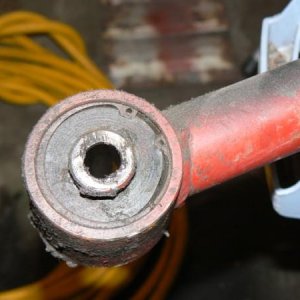

Well it might be new some of you. A friend told me about this, I had never heard of this but it worked. If you don't have a bearing race pull just put two one inch or so welds on it one on the top and on the bottom. Just make sure you don't weld the race to what ever you are pulling it out of. Then just let it cool down a bit. I got this one out with a screw driver.
