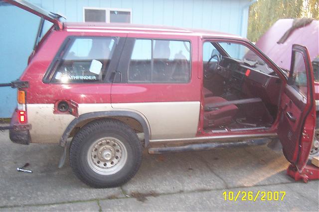

This is a slow build as i drive it deal. After fighting my toyota for a year i gave up on it. The new owner hasn't had any luck keeping it going either so i dont feel bad. I've totaled every cherokee i've had so i settled for building a family wheeler out of my wifes pathfinder. I've got three kids so this is how it has to be. I started with a 1990 4 door se 3.0 v6 5 speed.
what i want it to be: sas'd on 35'' tires , dana 44 waggy axle, 7 inches of lift max, winch on the front, partial cage (fender bars, sliders , rear tube bumper, front stinger) , street legal for the most part. Sounds reasonable and affordable for a family on a budget.

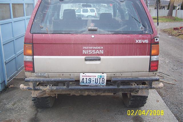

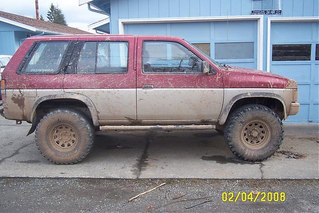

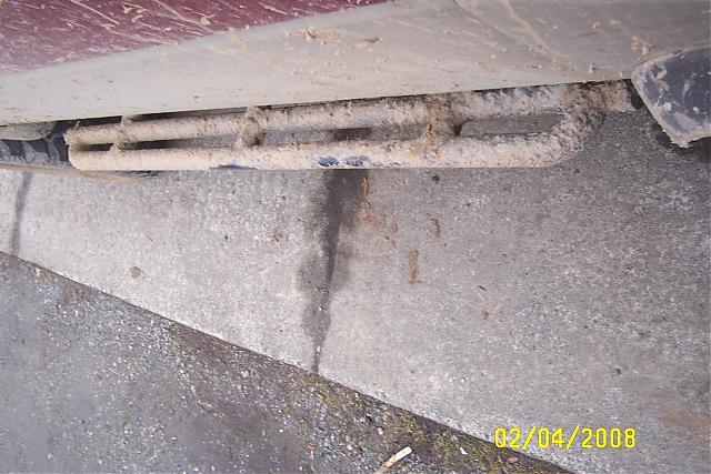

What it is right now: Ifs , 4.63 gears, homemade sliders, homemade rear tube, 33 inch pro comp tires on 51 crawler's, 14 inch travel shocks , cut off sway bars , 3 inch body, cherokee coils on rear, oddysey dry cell, and this week (tax money) its getting a 8000lb shittybuilt winch ($283 dollars new with free shipping from WWW.winchdepot.com ) the sas kit ( i will put on this summer ) and a front bumper.

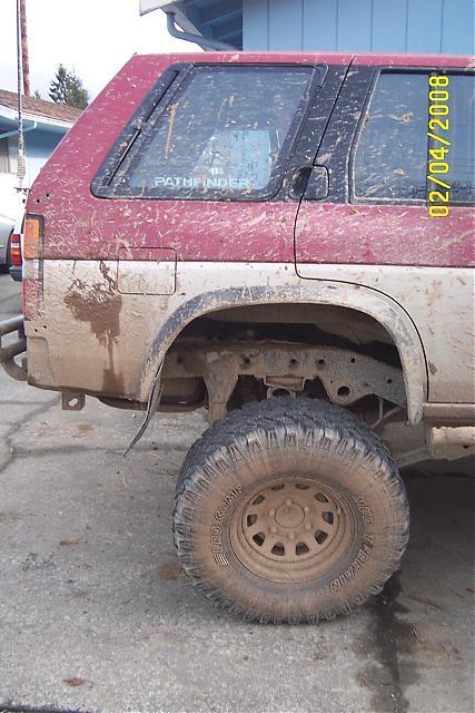

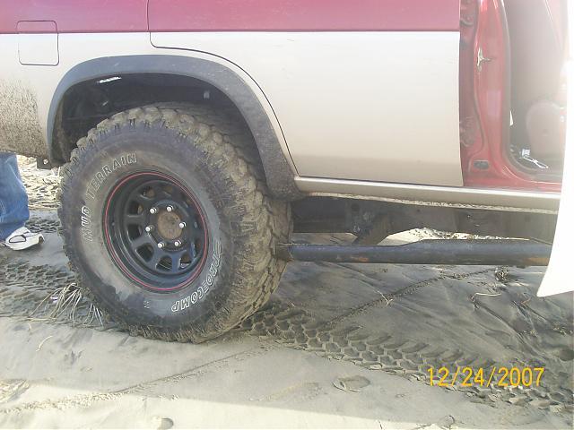

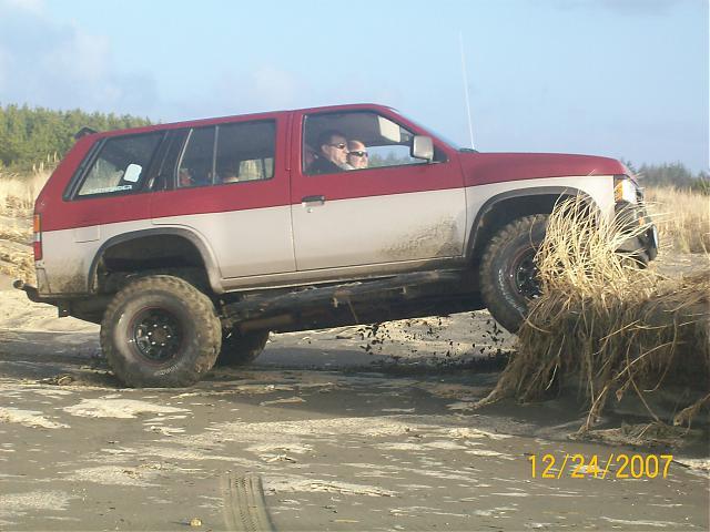

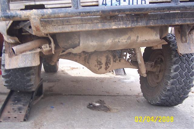

And more pics including my ghetto rti oil ramps designed specifically for nissans 7 inch travel ifs front end. The one pic is near flexed out on the rear but i will droop another two inches and the spring will fall out ( as i learned at walker saturday) Limiting straps are now on my list.:awesomework:

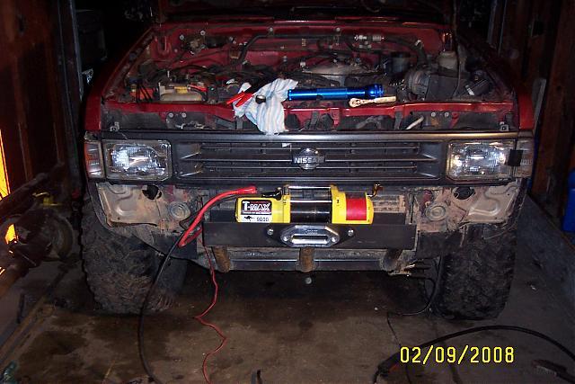

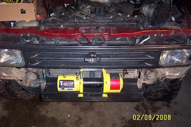

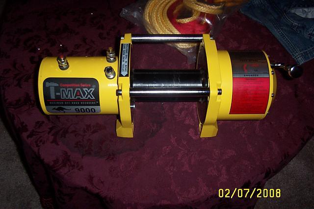

competition series t-max is here

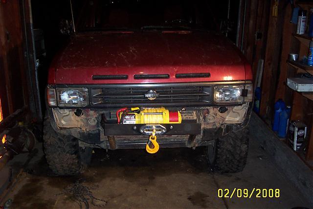

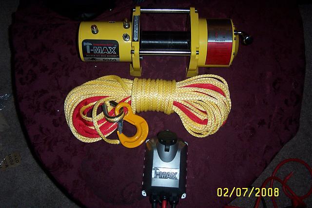

Well , despite the bright yellow this t-max 9000 seams to be nothing less than bad ass. It comes with 80 ft of synthetic rope, wireless remote, hawse fairlead, spare batteries, all cables necessary to install as well. And as always bellinghams hardware sales gave me a killer deal and i didn't have to wait for it to arrive.

$964 no shipping !!! The drum is that small. Its rope only. this thing weighs 55lbs. its has a 5.5 hp motor 3 stage planetary with 172.8.1 gearing. line speed is 11.48 ft a minute @5000lbs
I see you went for it!!!:awesomework: Gonna paint to match the rig?:corn:
Sounds like you got a pretty good deal.....:cheer:

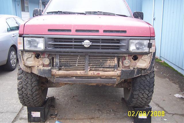

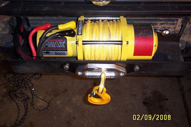

Nope gonna leave it ugly yellow. I think its growing on me. I still have to finish the supports that will go through the core support in the stock holes that were there and then put some tube to the sides to rap over to my sliders. It was a pain in the arse to put install. Someone in japan thought it would be cool if the body sat 3 inches forward of the frame. That same idiot thought that the frame should bend downward slightly. This is a big design flaw. How much of a stock pathfinder gets f'd up in a front end collision compared to a 4runner where the frame is even or past? Ill find comparison pics! The winch has a boomer box with all wiring headed into it so its a bitch to mount. I extended the leads and put it inside the truck as i couldn't find anywhere besides the under hood that it would fit. Under the hood would not allow it to disperse heat so i was against that. I had to build out the frame to get my plate mounted and that was the biggest pain in my ass. Any way its on , it awesome and im done bitchin about it.:redneck:
