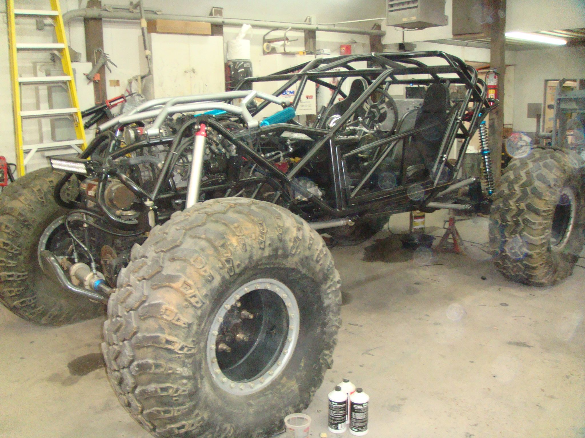

Ready To build the Skid plate, I was thinking aluminium? I have been seeing some run the Plastic? Suggestions... If it matters all tube bouncer chassis
