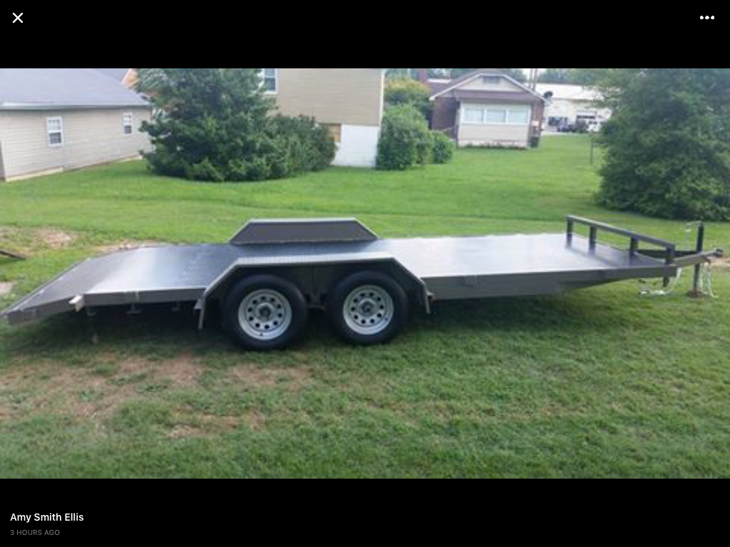

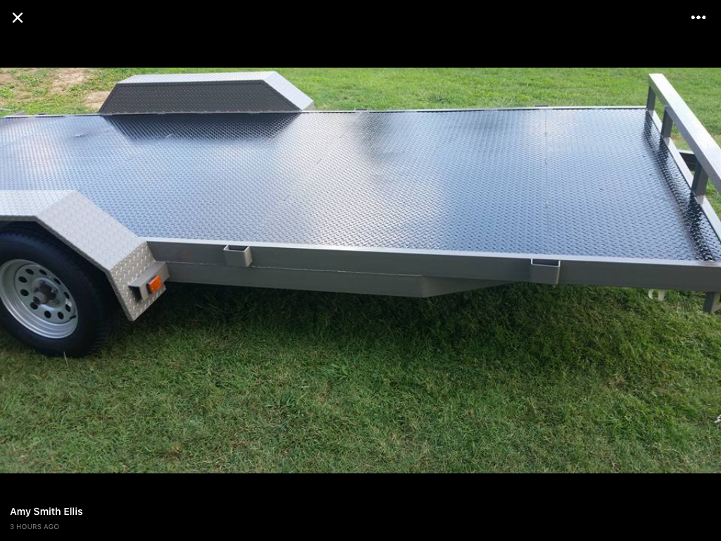

Mine before and after. Had a buddy make me some drive over fenders. wiped it's ass with red scotch brite. Sprayed the sides and rolled the flat.

Nice. Hope mine turns out half that good. Looks awesome. That the roll-on rustoleum?
I got a deal on some acrylic for the sides. And bought some cheapo mystic from tractor supply and rolled the floor. I barely took over a quart to do the floor. It took right at 2 quarts to spray the sides. I'll tell you, I didn't go to any extremes on it. Pretty much just knocked the dirt off of it on the sides. I did wipe the deck off with mineral spirits to get the oil and grease off.
