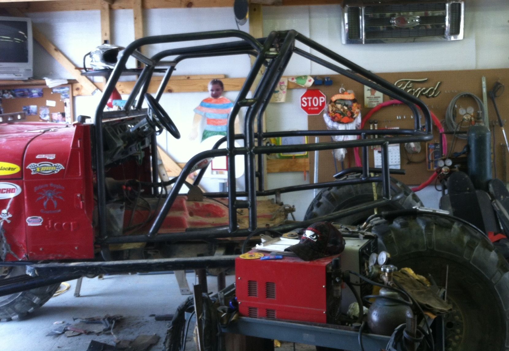

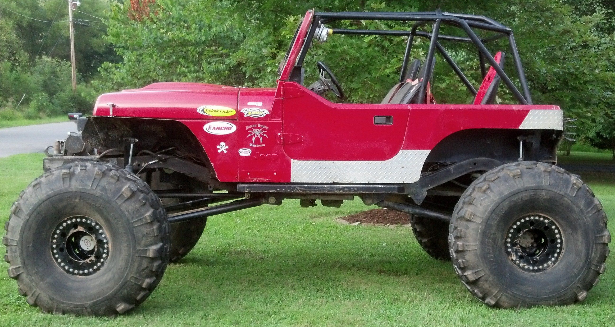

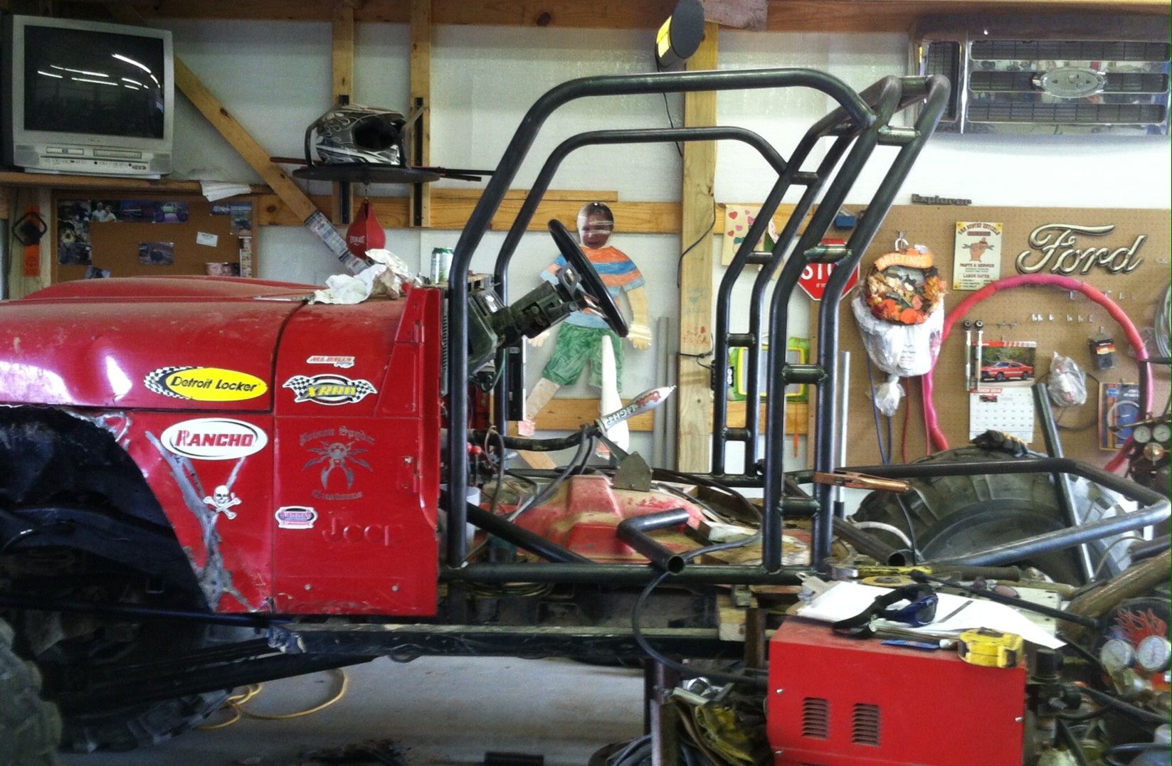

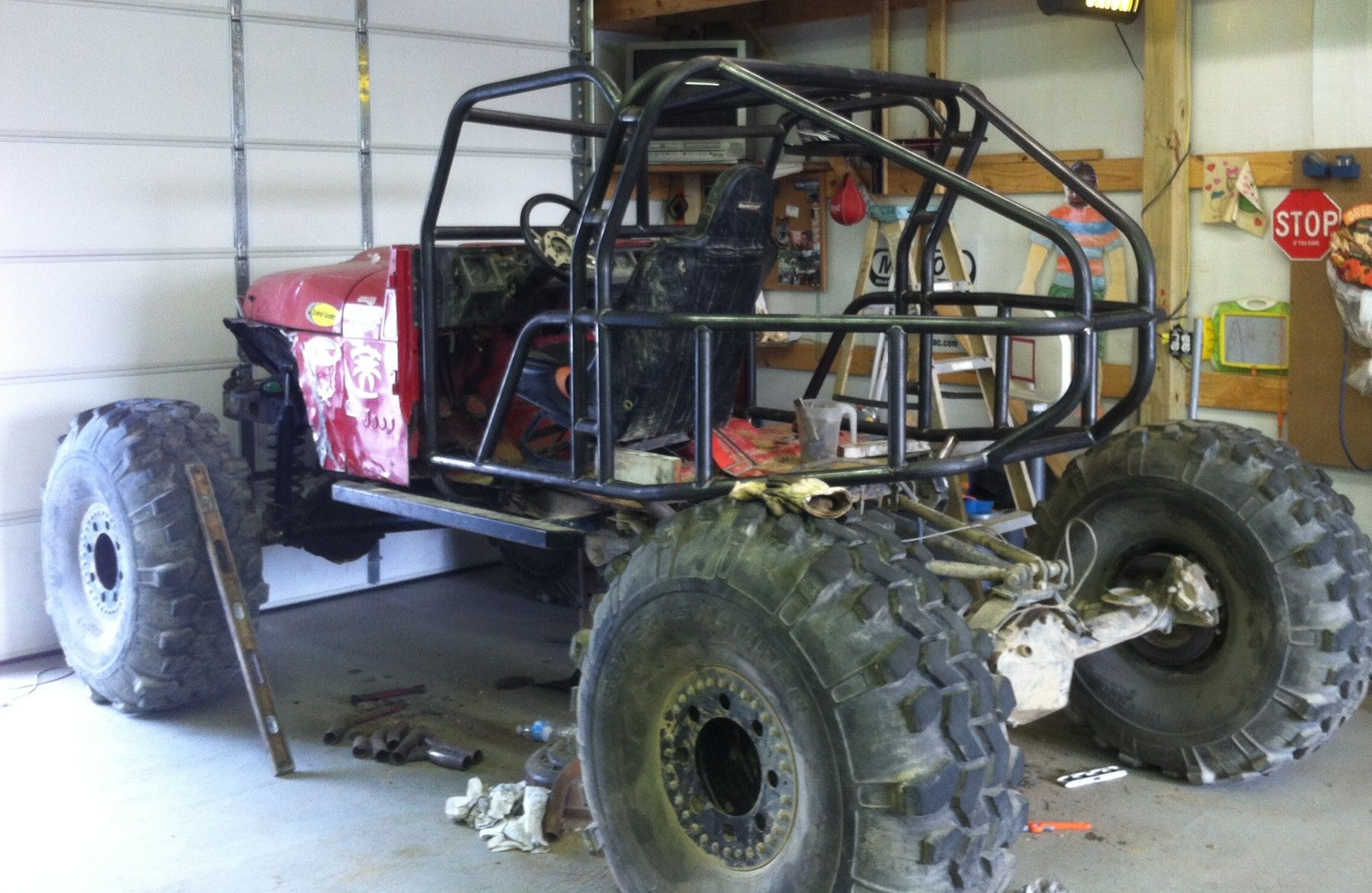

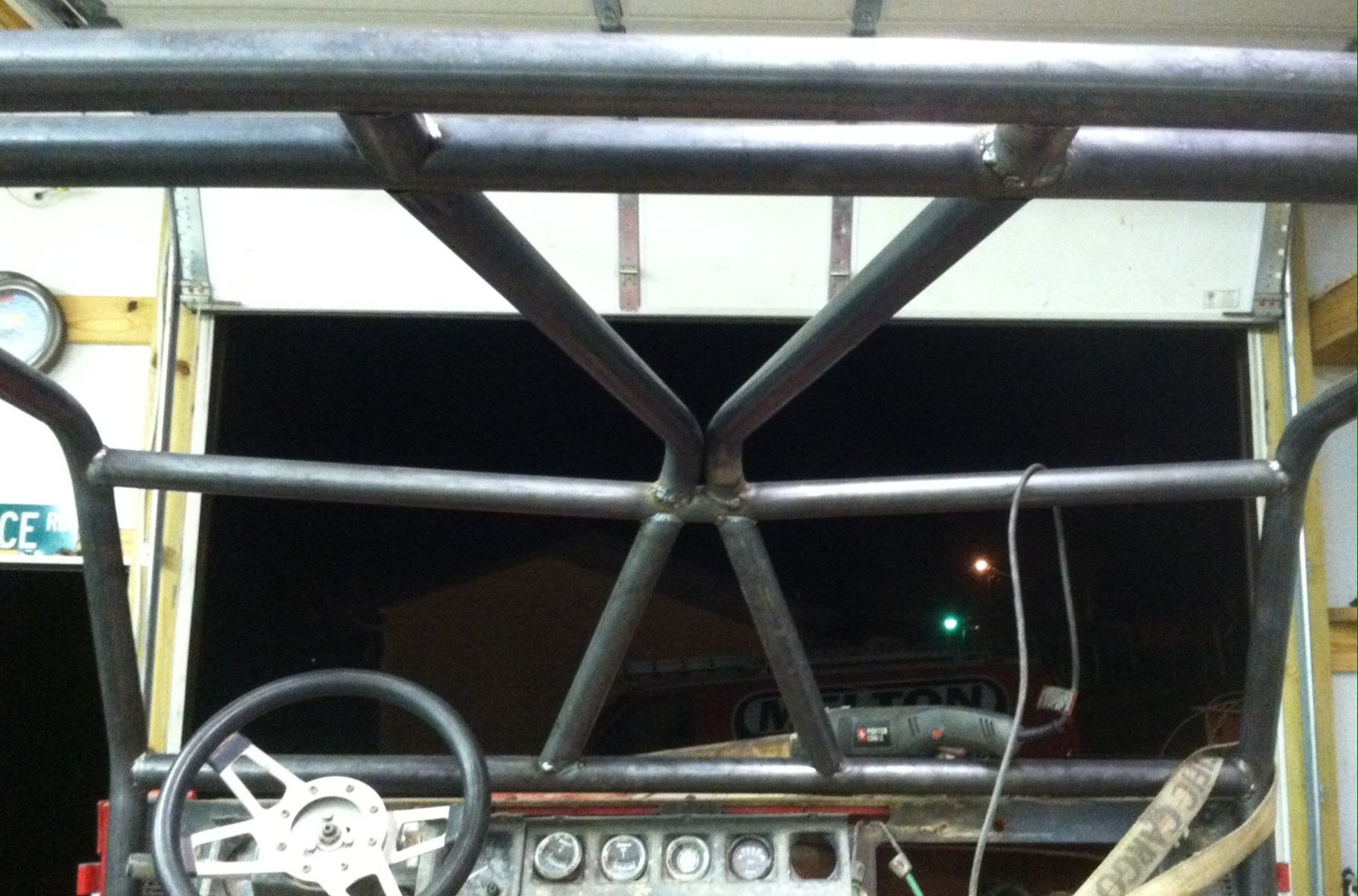

Started a few years ago with a streteched YJ. Poison Spyder cage, 302HO with a mild cam, leaf sprung, 42" TSL's, klune/205, 4-spd. Stetched to 120" and 4 linked last year and added aluminum heads, Cobra intake, 76mm mass air, 75mm t-body, and 44" TSL's.
Wheelbase is going to stay at 120", keeping coils up front and going to coilovers in rear, drivetrain is staying the same for a few months. New drivetrain going to include a 10:1 351W, mildly ported x303 aluminum heads, lightning lower w/cobra upper, 30lb injectors, 76mm mass air, 75mm t-body, cam to match heads and intake, and possibly an auto tranny.

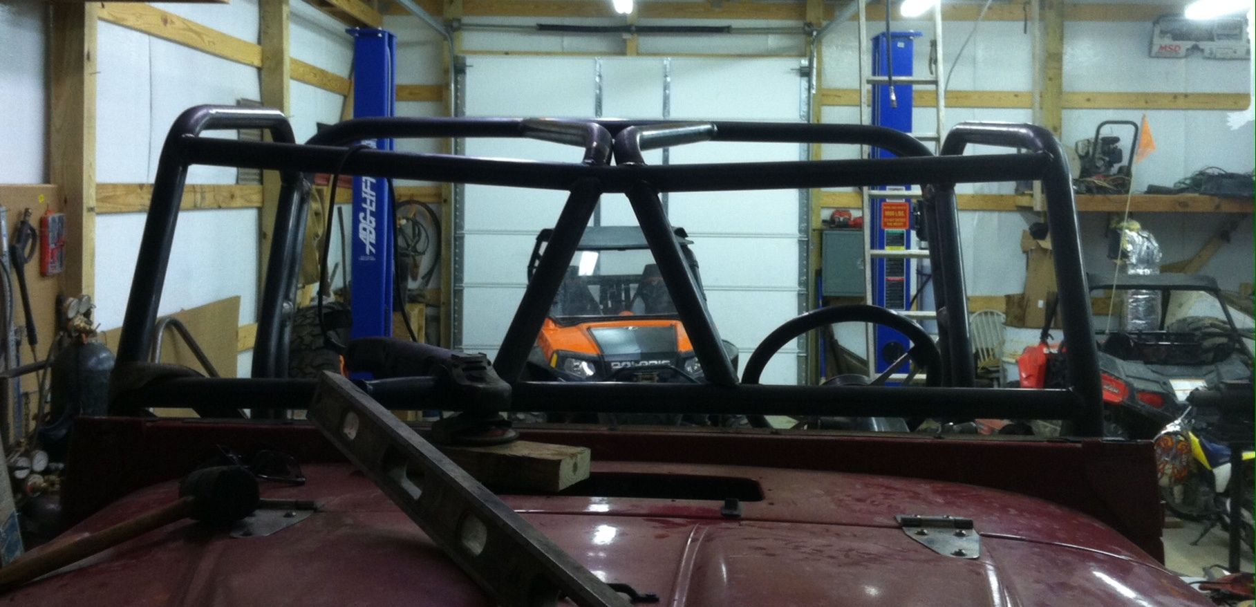

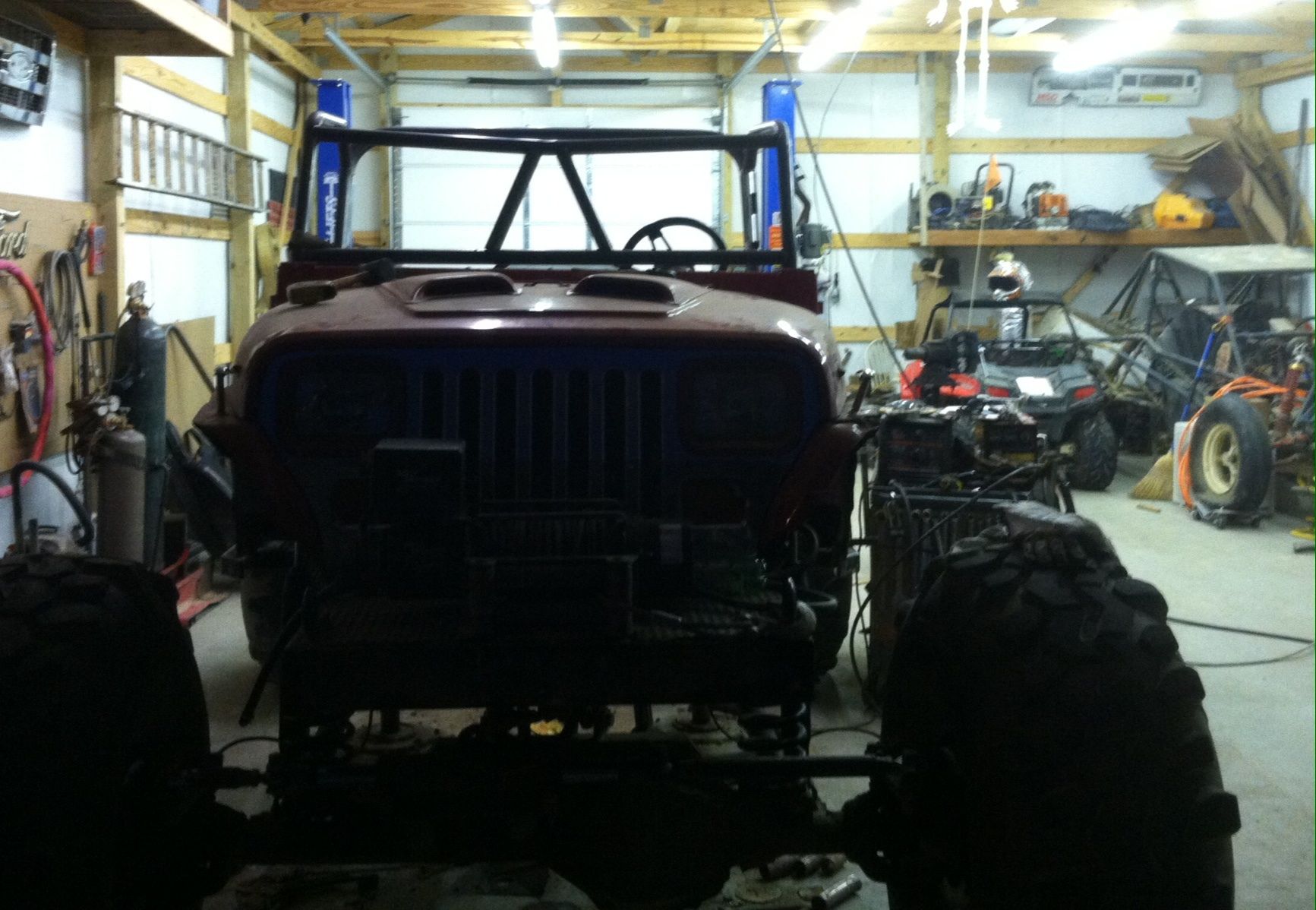

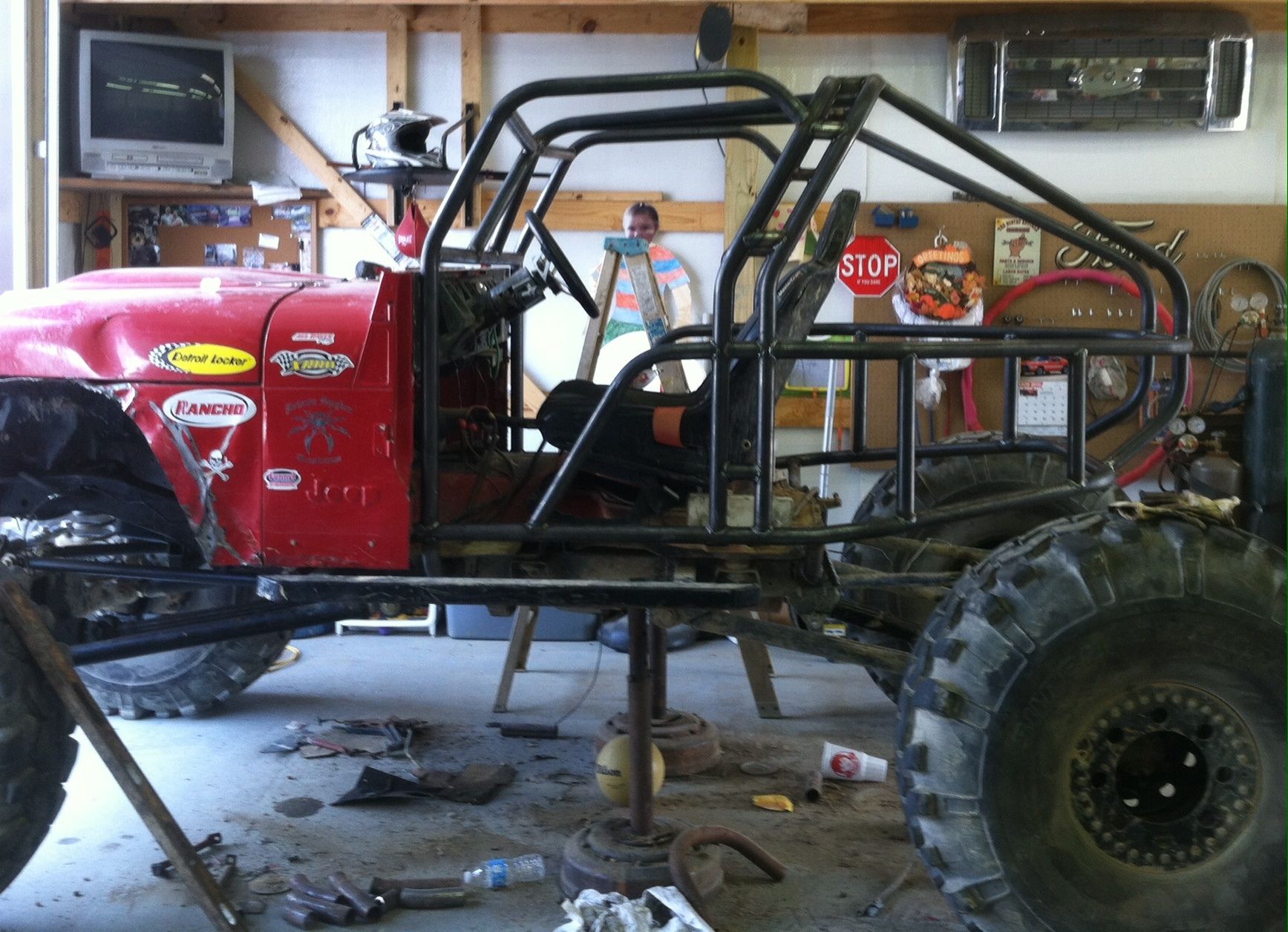

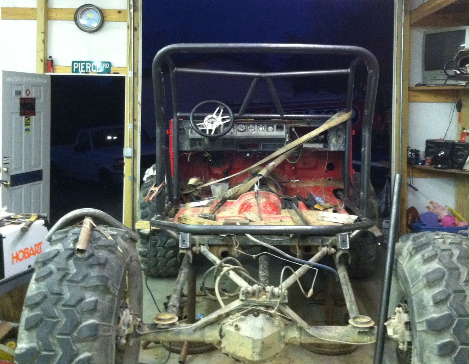

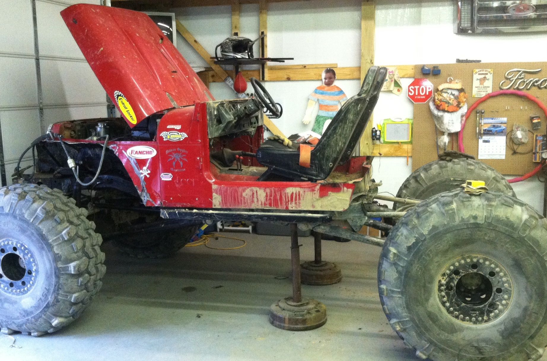

Jeep pics as it was two weeks ago. Cutting it up almost made me sick, but been wanting to back half it for a while now. I can't get the progress pics off my stupid phone, so fordcontraption, if you will post a pic of the main hoop section.
It's coming together quite nicely. Hate I had to leave y'all with it, but I knew it was in good hands. Another week or two and I'm ready for Atomic Ridge hitit
I'm all for atomic ridge but were gonna have to convince Wendy that it a good easy trail to ride and there's nothing to worry about :o :eek:
