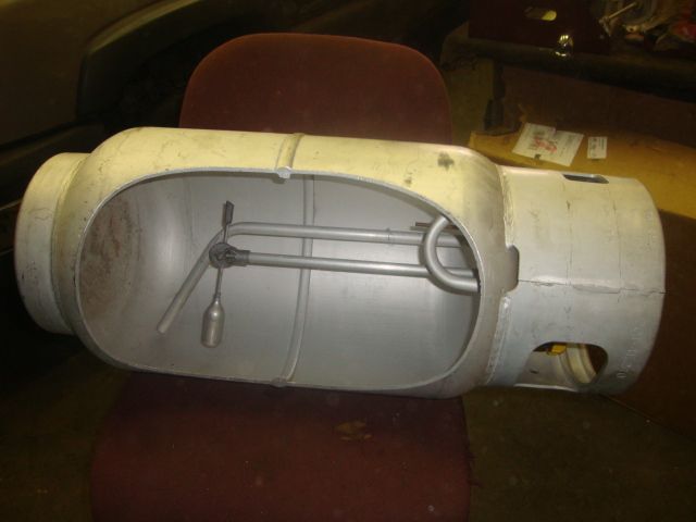

What he said and what you said are completely different about vaporizing. There is a liquid port hole and a vapor port hole in most propane tanks. He was stating to ensure that it is on the liquid side, which is the correct side, and not the vapor side. Liquid side has an actual pickup inside the tank, hence the need for proper orientation of the tank when mounted horizontally.
Spinning the tank is going to affect the bottle differently depending on which port the valve is in, liquid or vapor. Vapor will work if you can somehow mount the tank upside down so it can be gravity fed, but I not as reliably as one ran through liquid port with an internal pickup.

If you open your valve on the tank and it causes fuel starvation the excess flow valve is checking and cutting the flow. It is always best to open the tank valve slowly so the line can fill with fuel gradually and not shut the check valve. But you need to open the valve completely to keep proper flow.
The photo is a cutaway of a propane tank showing the fuel tube. It needs to always be at the lowest point however the tank is mounted.
