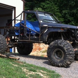

I got my Toyota 22 r kit from Nash lift trucks out of Kentucky. a lot cheaper than gotpropane kit and the customer service support has been really good
