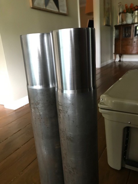

For those having tubes machined, have the first .5" or so tapered to assist in alignment when pressing the tubes in.

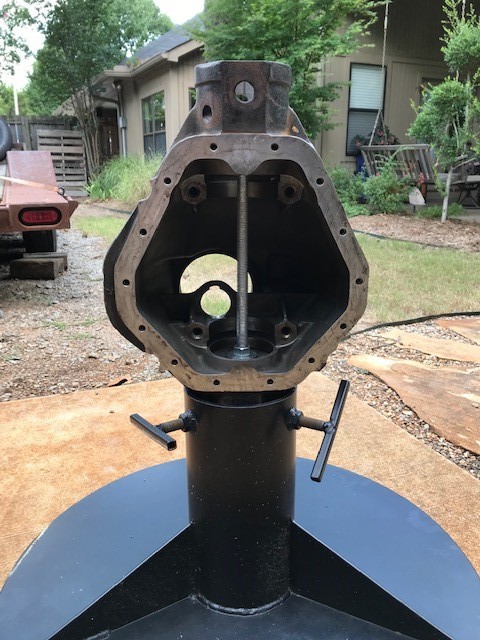

I didn't use an alignment bar...

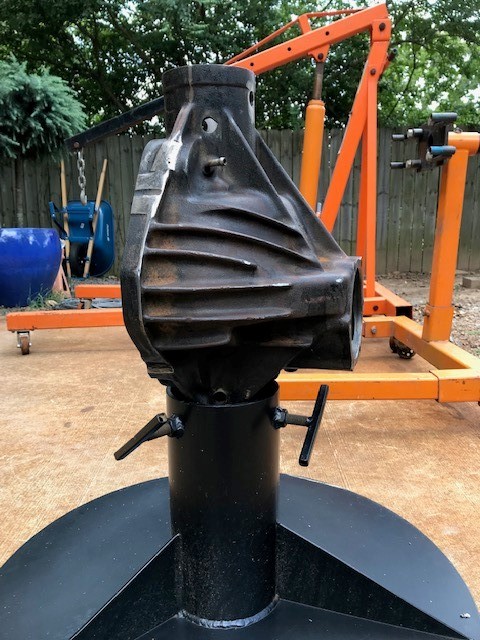

but I did use my Christmas tree stand!! :****:

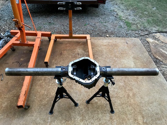

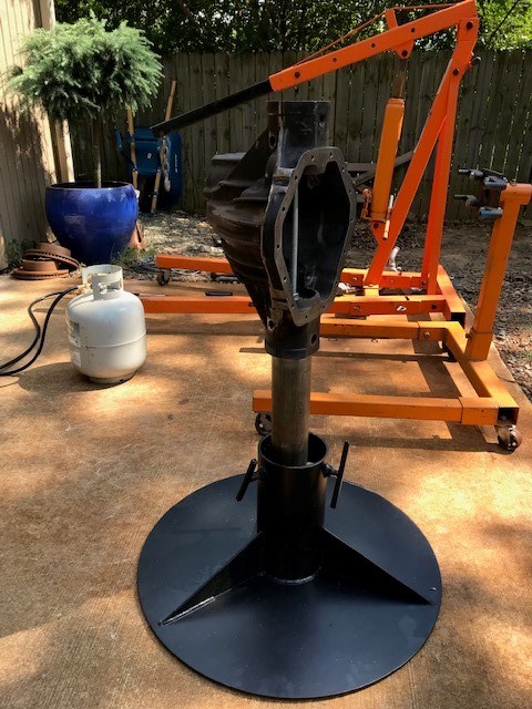

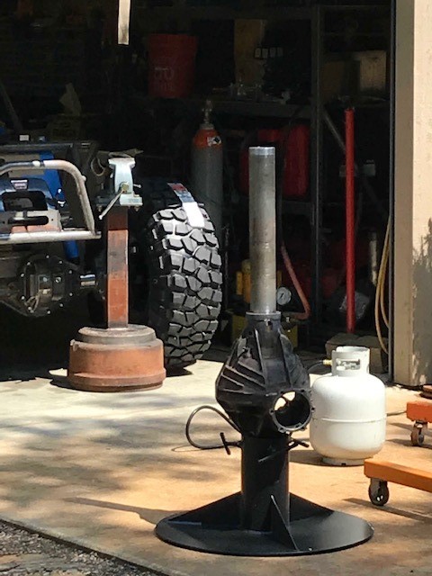

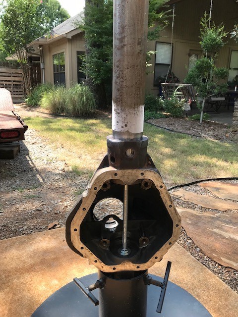

I fixtured my center section in my tree stand and leveled it. I placed my tubes on dry ice for about thirty minutes and let them get down to about -20F degrees while I heated the center section to close to 400F. That may have been excessive, but I knew the extra 100F temperature difference would buy me a few more seconds of slip fit to ensure I had the tube at full depth as dictated by the hard stop that I built. It couldn't have worked out better. Knowing that the center section was level and that the two cylinders were concentric, was not too concerned about mis-alignment. Additionally, I only plug welded the tubes in place; I did not run a bead around each end of the housing. I can't imagine the heat concentrated in those holes would cause the tube extending beyond the housing ends to warp. I don't have a lathe or fixture big enough to hold my entire housing in order to check run-out, but a string pulled through the middle indicates that I'm pretty darn close to true.

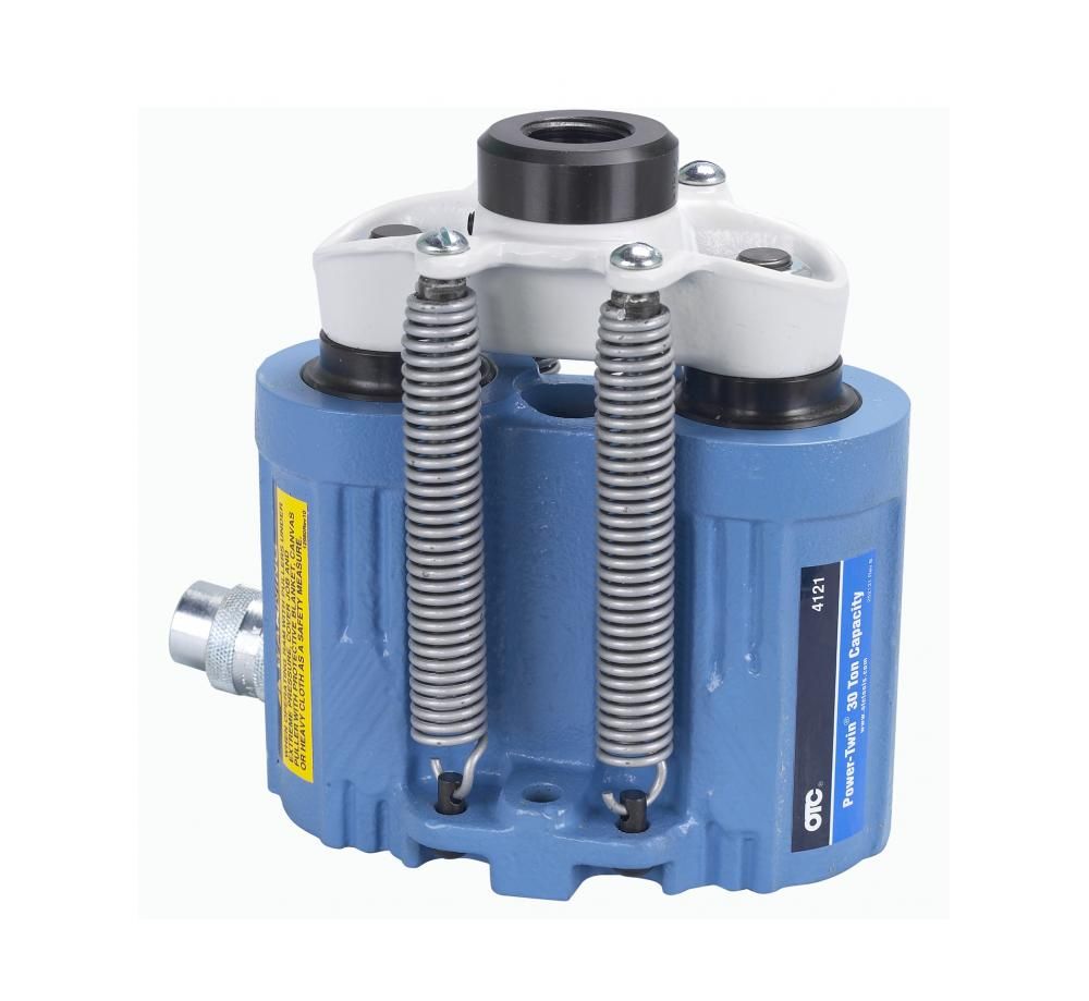

Pic and the tool to install the tubes
Seal housing

The rule of thumb for interference fits, per Machinery's Handbook, is .001" per 1" of diameter. For a 3.5" tube, that equates to .0035" of interference. At least, that's what I followed...
