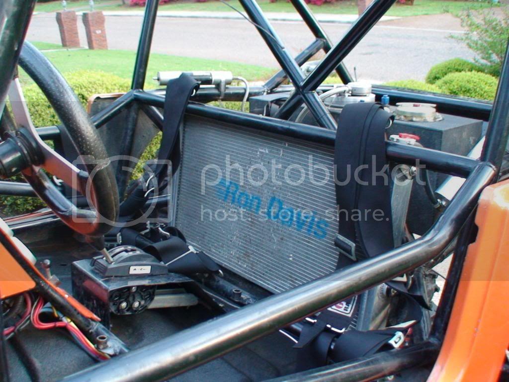

it is possible to have too much coolant volume...then your water pump can not keep up, and you end up having hotter coolant b/c it can't flow th eproper volume and the proper rate......this is one reason why i did not want and try a rear mounted rad.....lots of guys end up adding in an auxilliary elec. water pump....
fwiw...i am running a double pass Ron Davis radiator with shroud and fan.(double pass helps alot....)...i thought that it was going to be too much, but it seems to be doig fine....especially now that i have the charging bug fixed.....
the volume thing most people talk about is the coolant moves through the system too fast. it doesn't get a chance to transfer its heat to the fins before its rushed back to the engine. a double pass makes it so the fluid goes across from 1 tank to another, has to jump down the tank and go back across the lower half of the rad. this is accomplished by a plate being welded in the first tank halfway down below the inlet. you do double pass on a same side hose rad or you can do triple pass on one that is left/right hose. it let the fluid get truly cool. I have a summit rad and never ever get hot. I have never had a problem with too much rad. I have had a problem with flow.
I vote Ron Davis. I hate over heating as much as I hate catching on Fire.
My next buggy will have the exact same radiator as my jeep had and be mounted in the rear.
