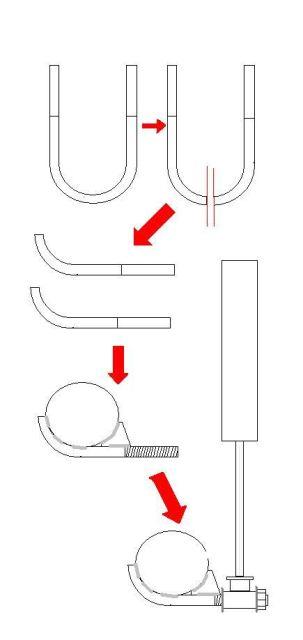

looking for axle brackets for your rear shock location. i cant mount mine on top of the diff, too tall of shocks. was looking for pics of some clean side brackets, faces toward the rear of the rig.
This probably isnt the best idea, but it works and locates the shocks at the bottom of the axle tube. you take a U-bolt same size as the axle and shock bolt. Cut the U-bolt in the center of the bend, weld it to the bottom of the axle tube with the bolt threads pointing to the rear, add a little gusset if ya like and you have a highly custom shock mount.
