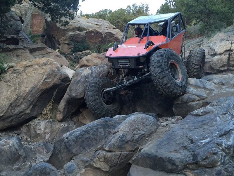

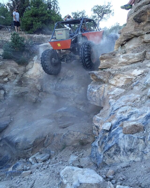

On a serious note, I don't have any issues with it being right hand drive. It feels completely normal to me.

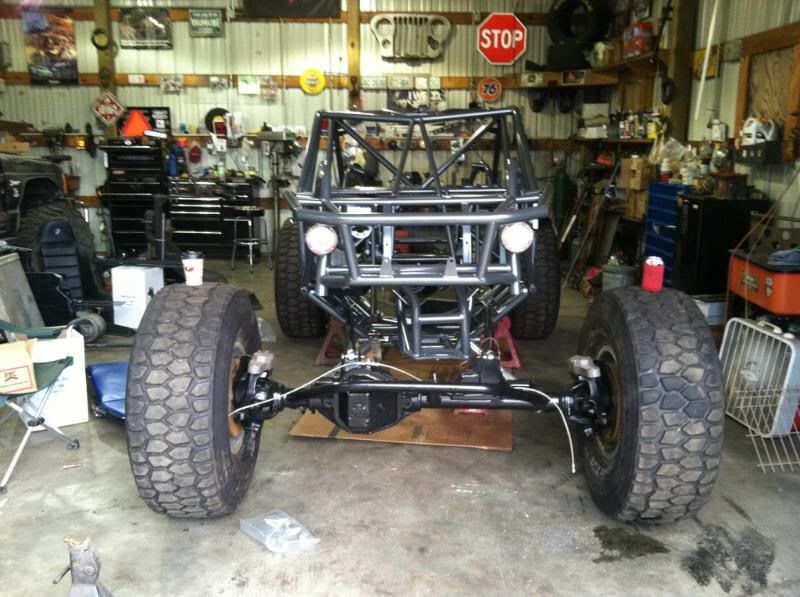

unless your drivetrain is offset, i fail to see how you would have more or less space for pedals. Now cleaing the master, sure since RHD it would be on the inside of the chassis. If that is a big factor, just swap pedals and stay LHD?
Good point that I forgot to bring up. My drivetrain is offset a lot to the "original" drivers side. This was to get a one piece driveline to eliminate a carrier bearing and any vibration. Chassis was originally built for ultra4 go fast racing. The original front axle was passenger drop, hence the offset motor.
Picture here shows the motor cafe but I don't have a good shot with motor in place. I think you will see what I mean.
