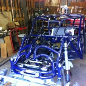

If I remember correctly 1.75 OD tube slides inside the frame and that would allow you to run a plate from frame to tube to reinforce it. I used 1.5" tubing for all of my cagework so I slid it inside the 1.75 and then welded it all up.
